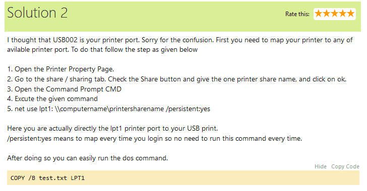

Here is a link to the page that did it for me ("Solution #2"):
https://www.codeproject.com/Questions/465476/copy-file-to-LP1-printer-using-commandline-in-wind

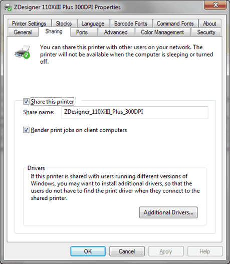

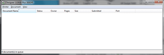

Open the Printers folder and set the desired Zebra printer as the default, then open its status window:
Click Printer, Properties, Sharing, “Share this printer” and name automatically gets filled in: ZDesigner 110XiIII Plus 300DPI
but change spaces to “_” to make the contiguous name: ZDesigner_110XiIII_Plus_300DPI
Associate LPT1 with that shared printer name…
In a Command Prompt DOS Box:
net use lpt1: \\loanerx220\ZDesigner_110XiIII_Plus_300DPI /persistent:yes
Then to copy a text (or ZPL) file to the USB printer in the shared name, use this (/B means send as binary):
copy /B checks1.zpl LPT1
