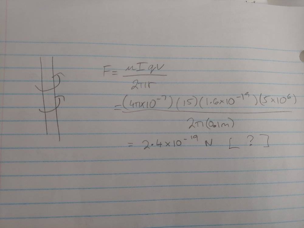

A straight wire has a current of 15 A vertically upwards, in a vacuum. An electron, presently 0.10 m from the wire moves at a speed of 5.0 x 106 m/s. Its instantaneous velocity is parallel to the wire but downward. Calculate the magnitude and direction of the force on the electron. Will this force remain constant?
F =(u I q v)/2pi(r)
Does this remain constant and what is direction

I tried downloading your picture of your work so that I could try to post-process it to be able to read it, but no joy so far. It's too light to be legible for me, even after processing. Please try to attach a clearer file of your work. Better yet would be to type your work into the forum, which makes it much easier to read and comment on.

Could you try to look at it now, I reposted the image
Thank you, that does help.

No I have not learned how to use vector Lorentz force. We learned the right hand rules and cross product.

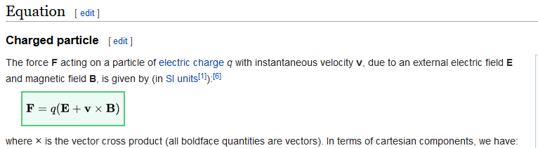

Okay, that shows that you are almost there. The vector cross product and the right-hand rule are the basis for the vector Lorentz force.
https://en.wikipedia.org/wiki/Lorentz_force
Since the electric field E is zero in the problem you are working on, the force on the electron is just
[tex]F = q(V × B)[/tex]

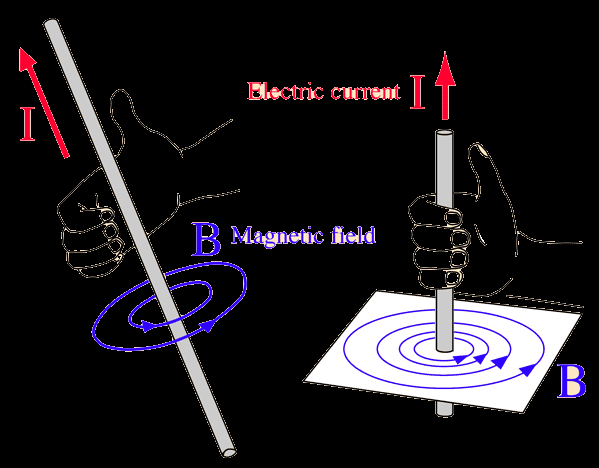

You correctly got the B field via Ampere's Law:
http://hyperphysics.phy-astr.gsu.edu/hbase/magnetic/magcur.html
I think in your re-posted work that you were not sure about directions. Can you use the right-hand rule to say which direction the force is on the electron? And will that change anything about the problem over time that would change the force on the electron?

Ya I am unsure what the direction on the force will be because the field is on a straight wire going around the wire while the electron is going down, and I am unsure of whether force is constant.
That's fair, so let's talk about it.
The current is going up in the +Z direction, and the electron is moving down in the -Z direction. By the right-hand-rule, which way is the B-field pointing at the spot where the electron is? Assume we put x-y coordinates in the horizontal plane, and put the electron at the point (0.1m, 0m). Which way is the B-field pointing, and using the right-hand-rule, which way does the Lorentz force push the electron?
