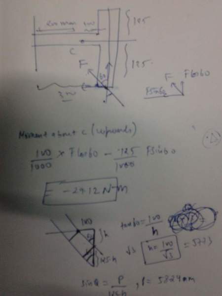

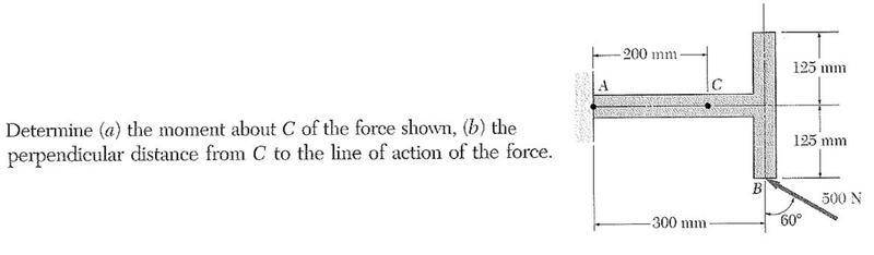

Hi I really can't figure out this problem, can you please help me out?
Thank you so much!
I have attached the problem and what I have done so far, I am just not sure its right...
Thank you so much!
Ignoring any minor rounding differences, your answers look correct to me. :approve:
