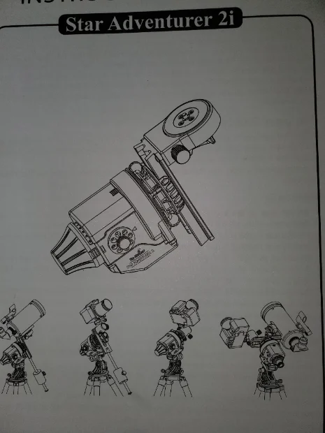

I bought the Star Adventurer 2i and could use some help aligning it. I live in the northern hemisphere. I can find polaris using a free AR star finder app, but can't see it in the sky nor the dipper. Possibly too close to nearest city. Also cloudy kind of a lot in the northern sky.
I would like to take longer exposures of galaxy but primarily had filming eclipses in mind as well as seeing changes in sun spots. I get the impression that with a telephoto lens the rig is setup to shoot in the north sky versus away? I would think my camera would need to be attached parallel to the rotating arm to look at sun, moon, and galaxy?

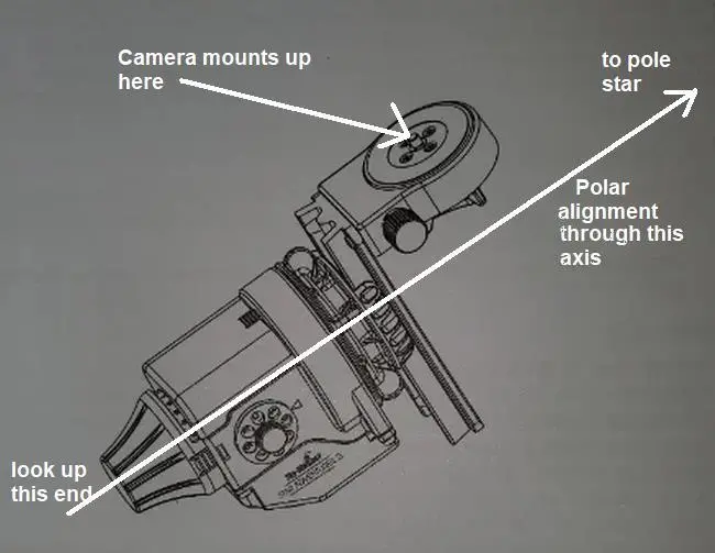

From the diagram it looks like you have a small polar scope that is used to align the mount to the north celestrial pole. I would take your gear out to a nearby spot where the sky is darker and get some practice using the polar scope to find Polaris and the pole. Try visually, then see if you can do it solely using your phone and the scope without having to see Polaris with your naked eye.

hi ya
I have one of these, wonderful unit ! :smile:
and I live and use it in the southern hemisphere ( Sydney, Australia)
below is an annotated section of your pic .... should be straight forward
feel free to ask Q's
regarding not being able to see much from home, stars wise .... ya just gotta get out of town
doing longer exposure under a light polluted sky isnt going to let you see more objects or see them better

In the cover diagram it looks like the camera is pointed in same northern direction as the scope that sees north star. I want to look away and a bit up to see most of the sky.

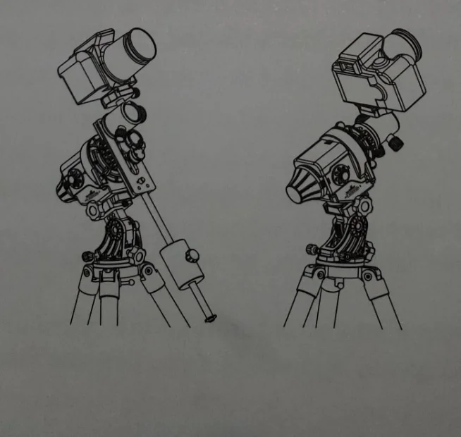

Looks like camera would need to also face north like in your diagram. Otherwise in the other direction facing roughly 45 degrees towards the ground.
This image from manual seems to show some cylinder on top of rotating arm with a ball joint that a camera is attached to. I don't seem to have these parts with the kit.

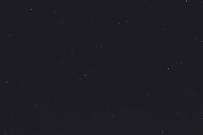

Tonight I set latitude pretty closely and lined up scope circle with only star I could see in northern 15% of sky. The star didn't appear yellowish as I've read polaris should be, but it did land in circle where it should of been in its path at that hour.
The camera should be able to pivot left and right in its mount. The Star Adventure 2i is an equatorial mount. Do you know how an equatorial mount works?
No, the camera can be rotated around on this mounting pad so that it can cover any area in the sky

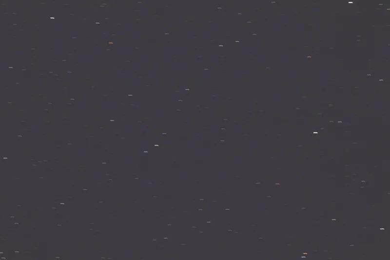

Thanks for the video. I don't think either of these had a scope though. Aligning seems to be the bigger issue for me. I saw the knob near the pad but didn't realized it helped to rotate the camera since I was focused on polar aligning before attaching my camera. In retrospect I should align after even though the bar slightly blocks the view. I took picture 1 for 4mins and 2 for 20mins. Less streaking than I was expecting since I couldn't see polaris. I would like to figure how to align during the day to watch solar spots. And lunar eclipses eventually.
I watched these videos previously. Still worried about bumping mount before hitting go.

You can try using drift alignment to fine-tune your polar alignment. Even those of us with polar scopes that can see Polaris often use drift alignment before a long session to minimize tracking errors. See here: https://www.explorescientific.com/pages/polar-alignment-using-the-drift-method
