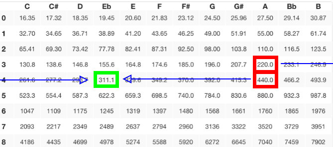

I tried to mimic the tone. The up-shifted tone was about as high as I can hum without scrunching up my face. Using an online pitch analyzer I (subsequently) estimate that was about 440Hz (and the lower tone then being 220Hz).

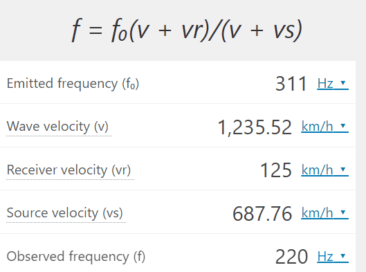

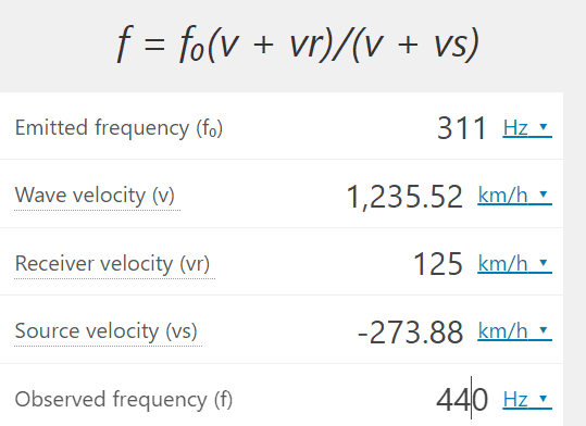

Yah, no. I'm not sure how to do this. For starters, I need to figure out what the un-shifted freq is (since that's what the equation starts with). It's logarithmically halfway between 220 and 440. which looks like it's about ... 311?
This is what happens if I plug it into a Doppler shift calculator:
If my numbers were right, I should get a consistent source velocity between the two, just with an inverted sign, correct?
So I have to ask myself where I made the (biggest) error. Either it wasn't a full octave shift I heard, or it wasn't 440Hz when it was oncoming.
Lets assume I was right about the octave and wrong about the up-shifted frequency.
My question then becomes: what would the relative velocity have to be to produce a doubling of wavelength from up-shifted to down-shifted Doppler pitches?

DaveC426913 said:
Yah, no. I'm not sure how to do this. For starters, I need to figure out what the un-shifted freq is (since that's what the equation starts with). It's logarithmically halfway between 220 and 440. which is about ... 305? Let me check a pitch chart....
