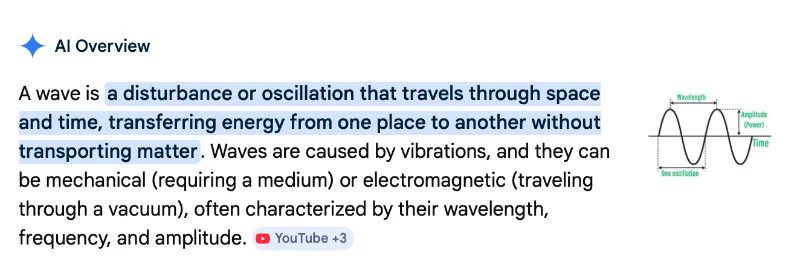

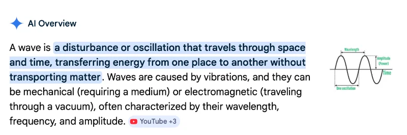

So I googled "What is a wave?" and this is what I got. If you go by this more complete AI overview and not by what Wikipedia says, your question is answered.
Google AI Overview definition of a wave, with a labelled diagram of a sine wave showing wavelength, amplitude and time, and one oscillation marked.
I’ve already asked several AIs before coming here—probably more than you did—and none of their answers were satisfying. The AI responses usually distinguish between two types of waves: linear waves and nonlinear waves. For linear waves, it’s true that they transfer energy without transporting matter. However, for nonlinear waves, such as those described by the Korteweg–de Vries (KdV) equation, matter can indeed be transported.
So matter transport should not be the key issue here, unless the AI explanation is simply incorrect. And this actually matches the idea in the Wikipedia definition.
