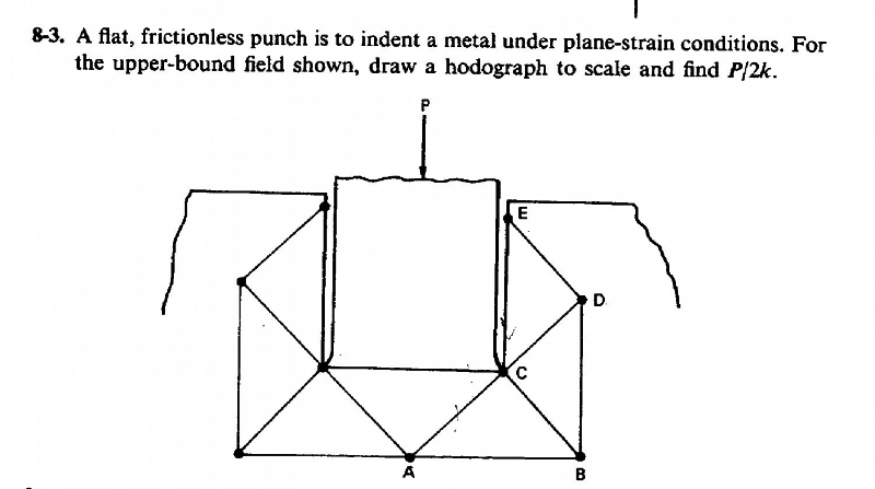

Hodograph for Punch Operation (Hosford and Cadell 2E 8-3)
  • Thread starter Thread starter 1350-F
The discussion centers on the punch operation analysis using the Hodograph method as outlined in Hosford and Cadell's "Materials Forming" (2E, Problem 8-3). Key equations include the rate of work done, expressed as dW/dt = k ∑ (S⋅V*) and dW/dt = P (w/2) Vp. The participant expresses uncertainty regarding the inclusion of a fifth velocity vector (V5) and the shear force on the CE segment, while calculating the pressure-to-shear ratio, yielding P/2k = 8, which is perceived as high.

1350-F
dW/dt = k ∑ (S⋅V*)
dW/dt = P (w/2) Vp
Attached: img005.pdf
I have some idea about the orientation of V* 1-4 based on the upper-bound field provided. Unsure if I should include a V5. Is there shear on CE? (Wrote DE in my work but meant CE) Also unsure what the magnitude of V*CE would be.
I got P/2k = 8. Seems high

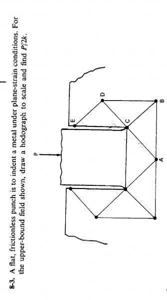

Rotated image!
