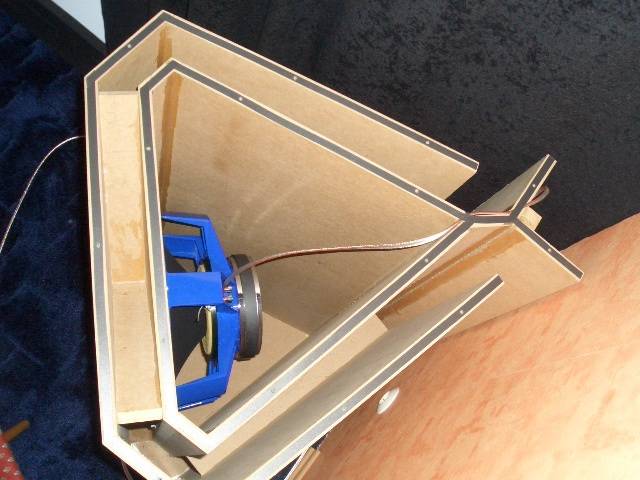

Aside from obvious option of moving the feet, the more important issue is close proximity reflections. Yes, of course it is accurate that at 35Hz the full wavelength is 32 feet, roughly 10 meters. Just because few homes have a listening room with such dimensions does not mean 35Hz is inaudible or useless (or problematic) in common room sizes.

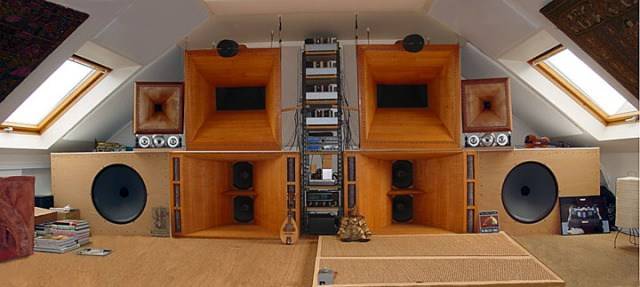

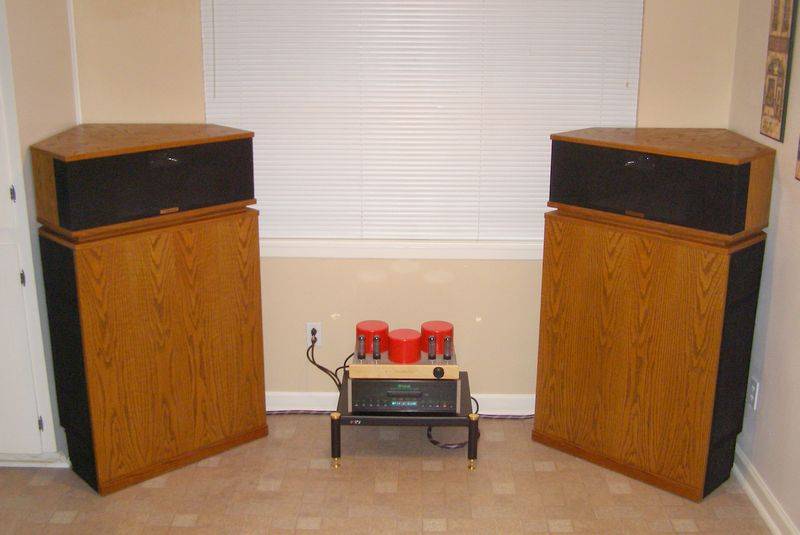

Perhaps few here have had the distinct pleasure of hearing one of these gems
Here's a detail of a derivative enclosure showing the spacers used to get a precise distance from a reflecting surface, preferably a corner
These, I assure you, could and did produce extremely serious frequency response below 35Hz with even moderately decent amplification since the sensitivity is 105db 1W/1M.
Granted, my concept of "decent amplification" may be a bit jaded since I still prefer valve/tube amps and even though it looks like a phasing problem requiring some tweaking I have to admit I'd REALLY like to experience THIS!

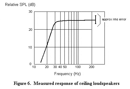

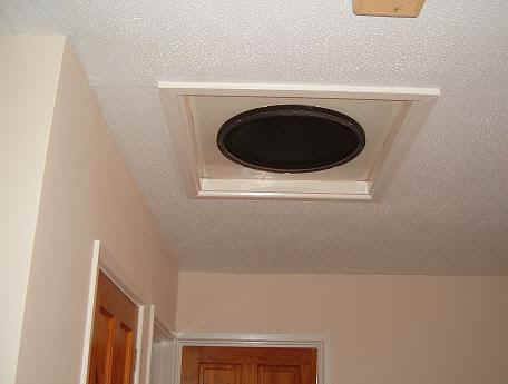

If you don't have issues with neighbours, a good solution is to use a wall or ceiling as an genuine "infinite baffle".
Here's a picture of an 18 in speaker used like that:
And the measured frequency response in the room:
As Enorbet's pictures show, if you want real low frequency sound you need to move a lot of air around. The speaker efficiency is roughly proportional to the square of the area. So an 18 inch speaker is about five times more efficient than a 12 inch, aside from the fact that its self-resonant frequency will probably be lower as well.
