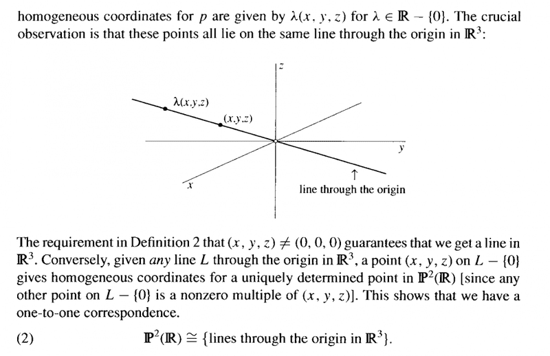

Diagram of a line through the origin in three-dimensional coordinates with x, y and z axes, showing points lambda(x,y,z) and (x,y,z) lying on the same line.

  • Diagram of a line through the origin in three-dimensional coordinate axes labelled x, y and z, with points (x,y,z) and λ(x,y,z) marked on the line.
