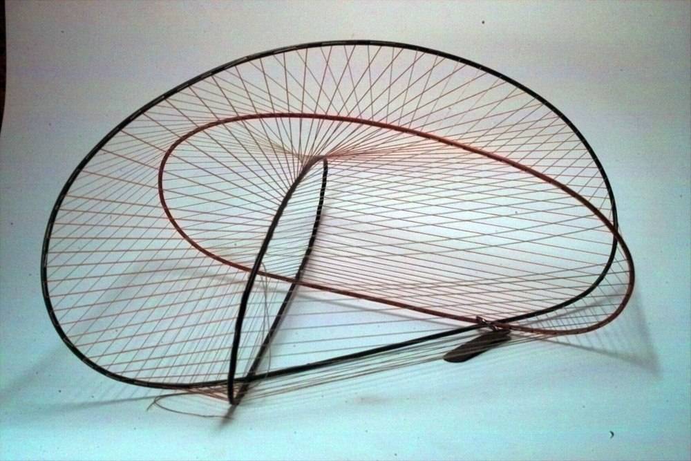

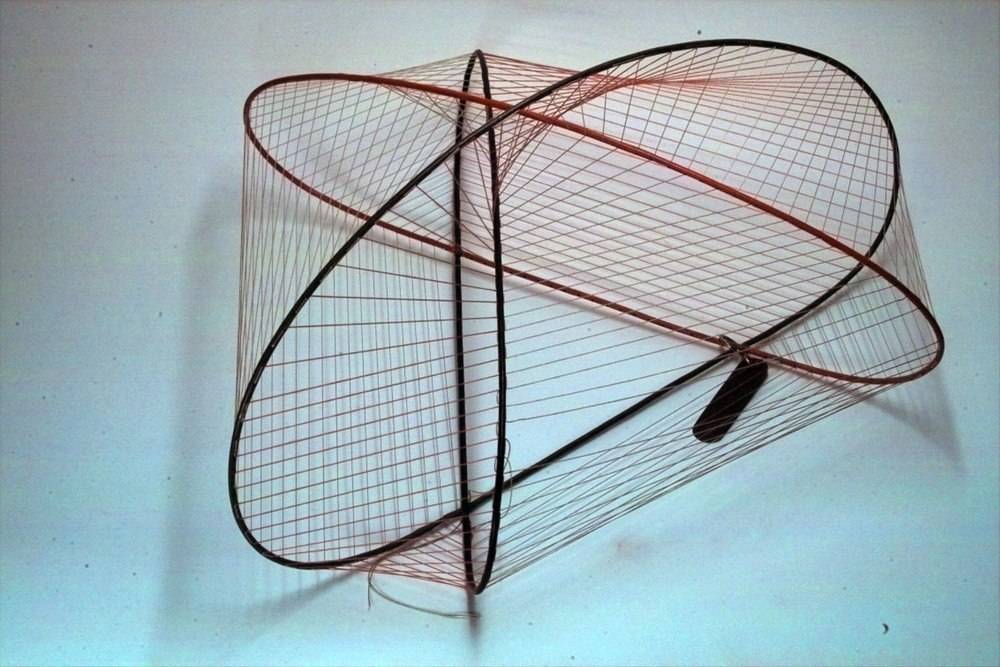

It is really hard to visualize the projective plane, even if visualized:
Physical wire-and-thread model of a Boy's-surface-style projective plane, with a black wire loop and a copper-colored loop crossing and joined, strung with many straight threads across the surface.
Physical wire model of a real projective plane, made of two intersecting elliptical rims joined by a grid of straight wires forming a ruled surface with a visible cross-cap.
