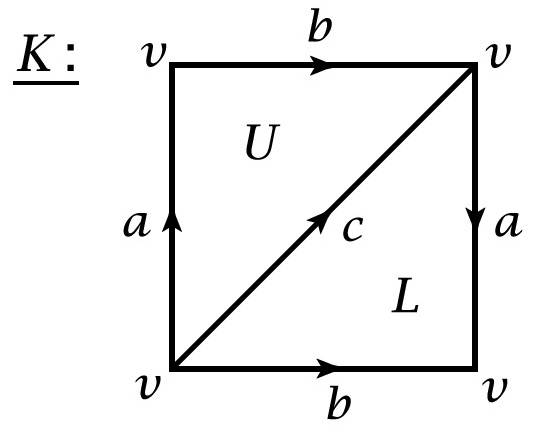

I am looking for some general guidance on questions of the form:
"Using a ## \Delta ## complex, compute the homology groups of the quotient space obtained fromt the 2-sphere ##S^2## by identifying three of its distinct points."
Similarly I have a question about a torus with two points identified.
I have a pretty good idea of how to compute homology groups with a ## \Delta ## complexes now for the Torus, Projective Plane, Klein bottle, etc. But what I am not understanding is what happens when I identify points to one another. i.e. I generally have some polygonal region ##I \times I## divided into triangles, i.e. for the Klein bottle:
But I don't know what happens to t his structure when I pick some points on them and start identifying them. What does my complex look like?
-Dave K
If you want to use simplicial homology you would have to retriangulate the space.
BTW: Your diagram is not a triangulation of the Klein bottle.
If you use Singular Homology then the Meyer-Vietoris sequence is the ticket.

The picture indicated is a ##\Delta## complex - it's the one from Hatcher. So, definitely a Klein bottle, not necessarily a triangulation.
I am also still sorting out CW-complexes, vs. ##\Delta## complexes , singular vs. simplicial homology and such ,so bear with me.
But the question does ask specifically about the ##\Delta## complexes.
-Dave K

If I understand it right, a simplicial complex is a Δ-complex. So you could triangulate the space.
You can also notice that attaching a 1 cell with its endpoints to two different vertexes of the surface is homotopically equivalent to identifying the two points.
Take a point in the interior of an n-simplex and subdivide the n simplex with that point as a new vertex. Do the same for the second point in the interior of another simplex. Then identify the two points.
Take a point in the interior of an n-simplex and subdivide the n simplex with that point as a new vertex. Do the same for the second point in the interior of another simplex. Then identify the two vertices.
Thanks for your reply. I was starting to suspect that about the 1 cell. I'll give it a try and get back to you!
The third paragraph was another way of doing it without attaching a 1 cell.

This shouldn't need an MV sequence to do since 1) we never learned it and 2) the question is about ## \Delta## complexes. It should be fairly straightforward. I'm still just not sure what the complex should look like. i.e. I don't know what represents two points being identified on it.
I explained in the first post that you need to subdivide the complex so that the two identified points are vertexes and then identify them.
BTW: Did you learn Excision?
The Meyer Vietoris sequence is incredibly important. I suggest that you learn it.
Oh, you did say to retriangulate, but that was all you said . So I didn't understand about the vertices. That makes more sense though and I will give it a try.
