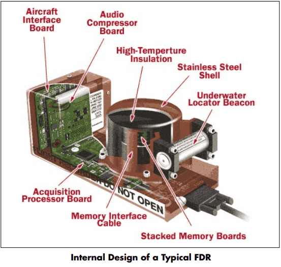

This image seems pretty specific, but I'm not sure you'll find the exact design files online since it's probably proprietary information.
https://www.aea.net/AvionicsNews/ANArchives/FlightDataRecordersJan06.pdf
There's also a video of a guy disassembling a smaller one for a private jet on YouTube, I assume you've seen it?
I saw the video but not the picture. I was afraid I would run into the 'its proprietary' thing, i guess I was hoping that there was some design commonly held as the correct way, this fairly similar between manufacturers, like car tires. Thanks for the help, I'll dig around on FAA forums I guess.
