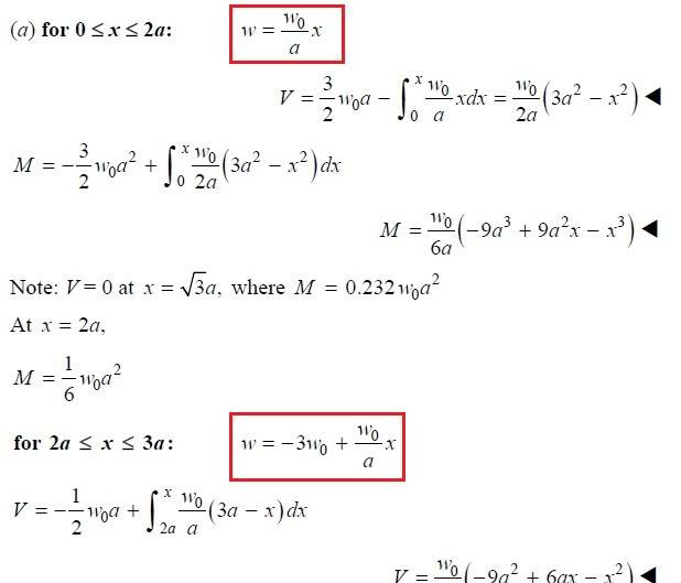

draw/find the shear and bending moment diagrams of:
Free-body diagram of a beam fixed at the left end with reactions Ax, Ay and moment MA, carrying a triangular distributed load rising from w0 at the right end to 2w0 at the left, with lengths 2a and a labelled along the beam and an x axis at right.
Handwritten worked solution for shear V and bending moment M along a beam, with w = (w0/a)x boxed for 0 ≤ x ≤ 2a and w = -3w0 + (w0/a)x boxed for 2a ≤ x ≤ 3a.
V : shear
M : bending moment
ω : distributed load
i already understood how the solution worked but i can't quite understand how the equations with the boxes were derived
What is the slope of the distributed loads with respect to the x-coordinate?
