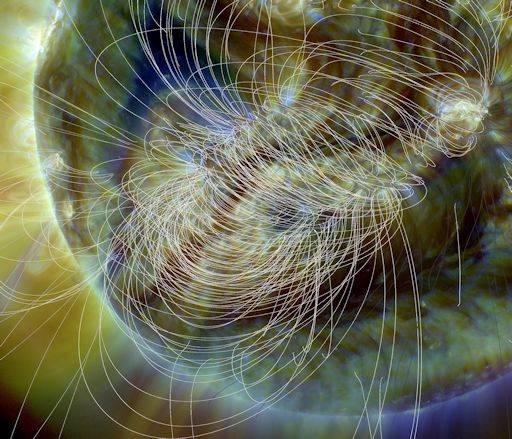

It's not well known, but the basic idea is that convection near the surface of the Sun "tangles up" the magnetic fields, which puts free energy into those fields, as evidenced by the presence of currents along the field lines. The free energy can be released when the currents are dissipated and the field returns to a less contorted state, and that can also lead to the ejection of gas and field energy into interplanetary space.
It's a great time to study a giant magnetic filament with the prospect of the rare Hyder flare erupting from it.
WHAT'S INSIDE THE GIANT MAGNETIC SLINKY?: A giant, slinky-shaped column of magnetism has formed on the sun, shown below in an extreme UV image from NASA's Solar Dynamics Observatory. What's inside the curly column? Click on the image to find out:​
It's a dark solar filament--essentially, a tendril of plasma more than 1,000,000 km long held suspended above the surface of the sun by magnetic forces. If the filament becomes unstable and erupts, it could hurl parts of itself into space. Pieces of the filament falling back to the solar surface would explode upon impact, creating one or more http://www.ips.gov.au/Educational/2/4/1.​
Astronomers with backyard solar telescopes are encouraged to monitor the structure as it turns toward Earth. A photogenic explosion may be in the offing. Solar flare alerts: text, voice
