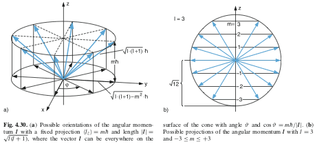

And how does it fit in with the picture of Precission of a Spin moment? For example if you will take a spin in a magnetic field, you will get a precission of that spin which you meant in your 2. post. But this spin precession (the movement of that cone) will relax in some time and the spin will be "aligned" with the magnetization. So it will looks lie a cone with smaler and smaler radius until its zero. But this spin can't be aligned with the magnezation when it comes to this damping. So it just stop to precess or how it can be explain?
Consider the following figure:
It is the classical representation of quantum angular momentum. The right panel shows the possible orientations for ##l=3##, where you see that the angular momentum is never actually aligned (in the classical sense) with the ##z## axis, but there is a state that is considered to be aligned (in the quantum mechanical sense) with the ##z## axis, the one for which ##m=l##, which is illustrated in the left panel. The position of the classical vector in that left panel is not fixed, since its projection is "delocalized" over the entire ##xy## plane.
This is not the same as precession. Precession comes about when the spin lies in the ##xy## plane and can be thought of as rotating in that ##xy## plane. As it relaxes, it starts to point towards the field (##z## axis), until it ends up completely aligned. Note that this representation of the spin rotating in the ##xy## plane is a classical representation. In reality, it is the expectation values ##\langle S_x \rangle## and ##\langle S_y \rangle## that have a sinusoidal behavior (the spin itself never points exactly along the ##x## or the ##y## axis for the same reason that it never points along ##z##).
So let me summarize and try to understand it:
When we apply a magnetic field in the z-axis on a spin in the z-axis he will NOT precess around it, because that quantum Alignment means that you have the closest and nearest position to the magnetization vector and that's what it called align with the magnetization. Thats the case when the spin has his maximum quantum position to the magnetization, but he is still delocalized in the that cone in the left pic.So then we have a spin in the state below the one before, if that was the m=3 state, then we have a state of m=2. (Is that what you meant wih a spin in the x-axis?)
Then we have a precession in the xy plane till it points in the z-axis by a apllied field in the z axis like before.By the way, you mean with the expectual values that the spin sometimes on the on one side and than around 180 degrees on the other side and the sum of this is the axis?But just consider the case where m ist zero, so you have the spin in the xy-plane and it would be locatied, right?
And just for make sure: you meant the "complited aligned" in the quantum sense right?
