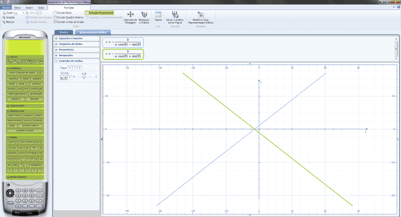

##r = \sqrt{x^2 + y^2}## ... ##(y = ax+b)##
##r = \sqrt{x^2 + (a x + b)^2}## ... ##(x = r \cos(\theta))##
##r = \sqrt{(r \cos(\theta))^2 + (a (r \cos(\theta)) + b)^2}##
https://www.wolframalpha.com/input/?i=r+=+sqrt((r+cos(t))²+++(a+r+cos(t)+++b)²)+solve+for+r
"r = sqrt((r cos(t))² + (a r cos(t) + b)²) solve for r"
solutions:
##r = - \frac{b}{a \cos(t) - \sin(t)}##
##r = - \frac{b}{a \cos(t) + \sin(t)}##
ploting:
So...
This answer is, of course, too much interesting! But, it doesn't the answer that I'm looking for...
I want that the straight of the Cartesian map becomes a curve in the polar and log polar mapping.
