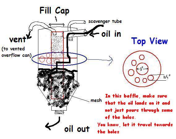

Very good answers here. This is similar to running a dry sump oil system on a race car. The reservoir tank must has a vent t o atmosphere to prevent a vacuum. Do not permit the return oil line to be submersed or you will never eliminate air pockets in the return oil. Make it exit so it goes thru an oil separator permit the oil to drip to the tank after being separated from the air bubbles. In this case a fine mesh screen works wonders. The way it is most effective is to have the return oil splash on a sheet metal surface ( red disc in attached pic) and have the oil flow over the plate for a few inches to scrub of the air bubbles then it exits thru holes located on the side opposite the splash point. Super simple, effective, cheap. No valves, no switches, no levers to break, plain old physics. And it works!

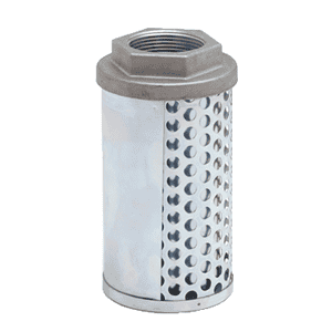

Could you share a photo of this fine mesh screen if possible? I don't think I could understand much from the illustration in your post.
Is it similar to those Oil Diffusers? Example -
Is it similar to those Oil Diffusers? Example - View attachment 351524

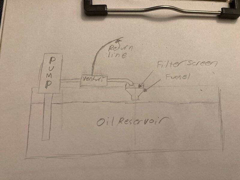

What size bubbles are you seeing in the foam? If they're in the 1mm or smaller range, that's the maximum mesh size you can use to get the desired effect.
You could seriously look at using a kitchen sink strainer to test the idea out and see how well it works. They're inexpensive, usually stainless steel and therefore should be compatible with your cutting fluid, and have a reasonably fine mesh to capture the foam.
Here's a sketch of how I'm envisioning the setup...
Take the output from the eductor venturi and feed it into the mesh screen in a large funnel at ambient conditions. Give yourself plenty of buffer space in the funnel above the screen, in case it backs up for whatever reason.
Ranger Mike is suggesting a system that does require constant flow and is more aimed at removing small amounts of air bubbles entrained in a system. Nothing against such a system, but it doesn't seem to be the right choice for this particular application.
