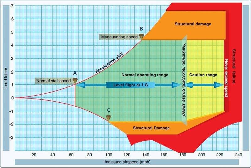

I am trying to calculate the critical loading conditions for Flaps (in order use them inside FEA to determine if the Flaps will be able to bear these critical loads) during the design phase of a civil aircraft.
Below shows the generic V-N diagram for most of the civil aircrafts.

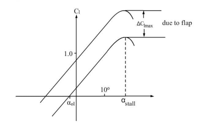

Now, I have the CFD results available for multiple combinations of angles of attack of the aircraft, with the deflection angle of the flap. I have to choose a couple, to input into my structural analysis of the flaps. How to determine the most critical loading conditions (Aircraft's angle of attack and Flaps' deflection at that angle of attack) for the flaps?
Now what is understood is that the greater the flap extension, the more overall Cl of the wing/aircraft (for the same angle of attack), and this will cause flaps to take more load during the flight (assuming that the extra load due to increase in Cl in just coming from Flaps only, and not from the actual wing).
Therefore, when the flaps are deployed to full extension, that is when the flaps should take the maximum load. How should I determine and calculate the load factor at this maximum flaps deflection, and also maximum flaps extended speed for this case? If these both are known, then the angle of attack of the aircaft can be found, and hence that specific CFD result can be implemented in my structural analysis of the flap.
Is there a limit on the load factor that beyond which the flaps cannot be deployed (or fully deployed) during flight? Is it possible for the flaps to be deployed fully when the aircraft is undergoing limiting load i.e. 4.4g and -1.8g (as shown in the V-N diagram above)? Or a completely new and different V-N diagram should be built for the aircraft, where flaps are completely deployed?

Flap limiting speed is determined by the peak force on the flaps. The airplane is rated for a maximum vertical acceleration. That acceleration is limited by stalling when below the maneuvering speed in the V-N diagram. Above that speed, peak acceleration is limited by the pilot. If the pilot exceeds those limits, structural damage results. The diagram above is for flaps retracted.
So the answer to your questions is in FAR Part 23: https://www.ecfr.gov/current/title-14/chapter-I/subchapter-C/part-23. Look for structural design envelope first, then outward from there.
