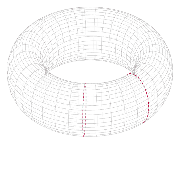

Hey all,
I have been looking into drawing a torus in LaTeX and came across the post Torus with lines winding along different axis, where the response by user194703 involved the following block of code (which I have very slightly edited)

The image produced I have also attached. The 2 dashed circles effectively create 2 sections along the torus and I wish to fill the surface of these sections with 2 different colors. If anyone could teach me how to do so I would greatly appreciate it as I am relatively new to drawing 3d graphics via tikz.
