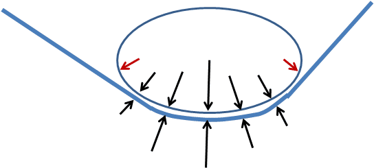

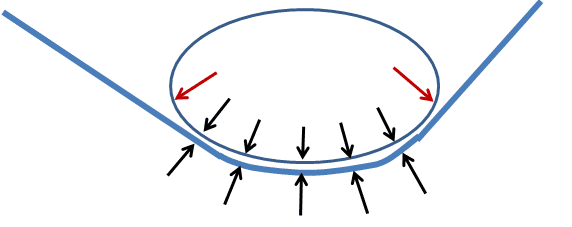

It does seem like a hopeless quest when we neglect the air resistance / terminal velocity thing. But wait...!
Let's look at it this way:
[1] If we pressed the egg into a really tightly stretched membrane with a force of 10 kg, it is likely to crack, even if we distribute the force uniformly over the top surface of the egg. But if the force on top is fairly uniformly distributed, the cracking threshold is likely to be still pretty high -- I'd say a couple of kilograms, because the lower surface is cradled nicely to distribute the balancing upward force.
[2] However, the deceleration force(s) don't act on the top surface -- what is decelerating is mostly the white and the yolk, and by Pascal's principle they would produce a pressure spike all over the inside surface of the lower part of the shell. Once we take this into account, what can crack the shell is only the small non-uniformities in net force caused by the behavior of the membrane when it tries to stretch and match the shape of the egg. That is, if the membrane allows some parts of the yolk to decelerate more slowly than others. I think this gives us a significant margin in our favor.
