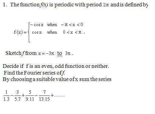

Having difficulty with this Fourier series function. I know that it is an odd function...can anyone help me

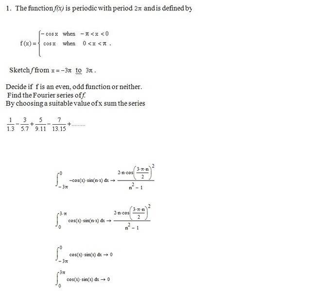

see attached
It is poor practice to hijack a thread about one question by posing another question. You should start a new thread with your question.
poconnel said:
see attached
The function is periodic with period [itex]2\pi[/itex]. Why are you integrating over a range of [itex]3\pi[/itex]?
I believe even though sin and cos are periodic over 2 pi a Fourier series is a representation over the given period and so the integrals must be taken over the period given. I forgot to multiply the integrals by [tex]\frac{1}{3\pi}[/tex]
No. You are given a function on [itex](-\pi,\pi)[/itex]. That function is extended periodically. The fact that you were asked to draw its graph over an interval of length [itex]3\pi[/itex] doesn't magically make the function periodic of that period.
The problem asks you to determine whether the given function is even, odd, or neither. If it is one of the first two, that suggests using a half-range expansion.
You are, as the saying goes, barking up the wrong tree.
What do you need help on? That last bmp looks like you have calculated the Fourier series correctly. Do you see what the answer to the original question is?
