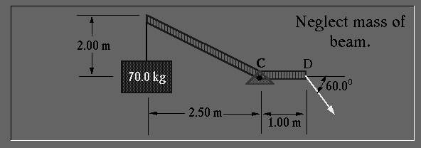

Find the components of the force at D and C using moments
picture attached
M=F x r
I'm really stuck on this one. The force from the 70 kg weight is 70*9.8 = 686N, so F=-686j. I found the moment about point C to be Mc=1715k. After that, I'm not sure where to go. I'm also really thrown off by the white line that's at a 60° angle below the x axis. Any help would be greatly appreciated. Thanks.
  • Diagram of a beam pivoted at C with a 70.0 kg block hanging from its left end by a vertical cord 2.00 m above the beam, a 2.50 m horizontal distance from C to the block, a 1.00 m segment from C to D, and a 60.0° angled arrow at D; labeled Neglect mass of beam.
It looks to me that the white line is an arrow representing the force required to keep the device in equilibrium. Does that help?
Yes, it does help thank you. I still don't know where to go from here though. I guess I'm not really sure how the moment about C would translate into components of force.
Well, do you not know enough to be able to calculate the white force itself, even if you don't know its components?
