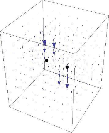

Hi, i would like to know how can i plot a three dimentionnal phase space (mathematica), for this kind of differential equations:
x'= (z^2(x-4y+z)+y^2(x+z)+z(x*y-x^2))/(z^2+x^2-2)
y'=y(y-3)+z(4y-z)+3(1-x^2)-2(y-3z)(z^2(x-4y+z)+y^2(x+z)+z(x*y-x^2))/x(z^2+x^2-2)
z'=2y-z(z^2(x-4y+z)+y^2(x+z)+z(x*y-x^2))/x(z^2+x^2-2)
do i need to solve numerically this system and then plot its solution?
The phase space itself would be ##\mathbb{R}^3## (or: a subset of ##\mathbb{R}^3##), so for that there is not much to plot. (Just three axes.)
You could plot the vector field defined by the right-hand side (I think Mathematica can do that?) or you could plot some "typical" solutions. For the former, you do not need to solve the ODE, for the latter you do need to solve it indeed. A combination is also possible: Plot the vector field and superimpose on this a plot of some typical solutions starting from various initial conditions.

Hi, thank you for your reply. Actually what i am trying to do is to plot the phase space of my dynamical system and superimpose on this plot the critical points of this system in order to study the stability of these critical points. Here is the result of the plot, unfortunatelly i didn't get any useful information from it.
I would like to know what did you mean by "typical" solutions?
Probably you already calculated the eigenvalues of the linearization at the critical points? Could you draw any conclusions regarding (local) stability from that?
Yes, i did, actually i found some sadlle and stable points. But i was wondering if i could confirm this result by ploting the phase space.
