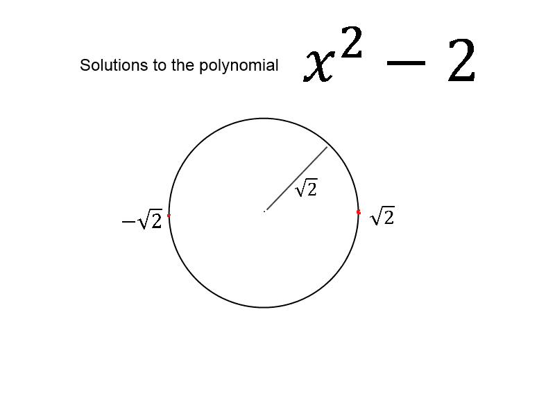

I'll start with ##alg(x^2-2, 1)##
All values for x in ##x^2-2=0## is with numbers assigned following my rules:
1. ##\sqrt{2}##
2. ##-\sqrt{2}##
I have also drawn these values on an image in attachment A
And it's the first one so ##alg(x^2-2, 1) = \sqrt{2}##

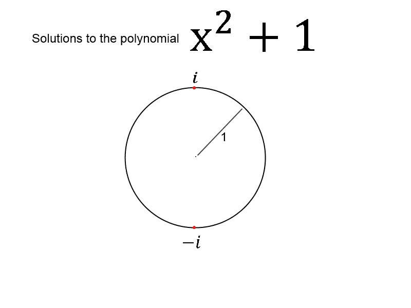

Then for ##alg(x^2+1, 1)##
All values for x in ##x^2+1=0## is with numbers assigned folloing my rules:
1. ##i##
2. ##-i##
I have also drawn these values on an image in attachment B
And it's the first one so ##alg(x^2+1, 1) = i##

  • Diagram of the roots of x^2 - 2 on a circle of radius sqrt(2) centred at the origin, with the roots -sqrt(2) and sqrt(2) marked as points on the circle.

  • Diagram of the solutions to x^2 + 1 = 0 plotted as points on a circle of radius 1 centred at the origin: i at the top and -i at the bottom, marked in red.

One feature of your notation [itex](f(x),k)[/itex] is that the same algebraic number has many different designations. For example, as I understand it, [itex]((x-1)(x-2)(x-3),1) = ((x-1)(x-5),1) = ((x-1)(x-1),2)[/itex] In coordinate systems where the same point has many names, it is useful to identify a "principal" name for the point. I don't see how to do that in your system.
In proving that the product of two algebraic numbers is an algebraic number, we have to show that there exists a polynomial with rational coefficients that has the product as a root. So to investigate a rule for computing [itex](f(x),k) (g(x),j)[/itex] , you should look at the methods used in such a proof. I haven't looked at them recenty. The Wikipedia article on algebraic numbers says the proof can be done by computing the "resultant" of two polynomials. However the Wikipedia article on "resultant" looks inscrutable. Perhaps this article is clearer http://www.google.com/url?sa=t&rct=...pi9jca8Ot3KNyaQ&bvm=bv.47534661,d.aWc&cad=rja. The "resultant" of two polynomials seems to be defined as a number in modern sources, but in older books it is defined as a polynomial. I don't know the technical terms that distinguish between resultant-as-number and resultant-as-polynomial.
