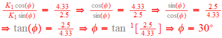

Thank you.
I hope it's correct. Could you please give it a look?
Looks good, and the result is correct of course.
One caveat: There is a bit of ambiguity. An angle that is larger/smaller by 180 degree and the opposite sign for K1 at the same time lead to the same result, and changing the angle by 360 degree doesn't impact the result either, so you can't notice that. Usually this isn't a problem in applications, but it is something to keep in mind.
