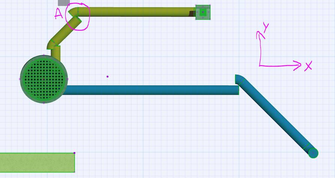

Hi All.
I'm new here so I hope you will bear with me and please tell me if this is out of context or in the wrong part of the forum.
I am trying to programm a falling pipe system with corners in ArchiCAD (GDL).
I have been programming in different languages for a while now, but new to 3D vector coordinate programming and never really had to face complex mathmatical challenges like this.
I am hoping you Maths experts will be able to help me with this as I have now spent days trying to get it right and am slowly going crazy!
OK here we go. Hope its not too complicated to explain...

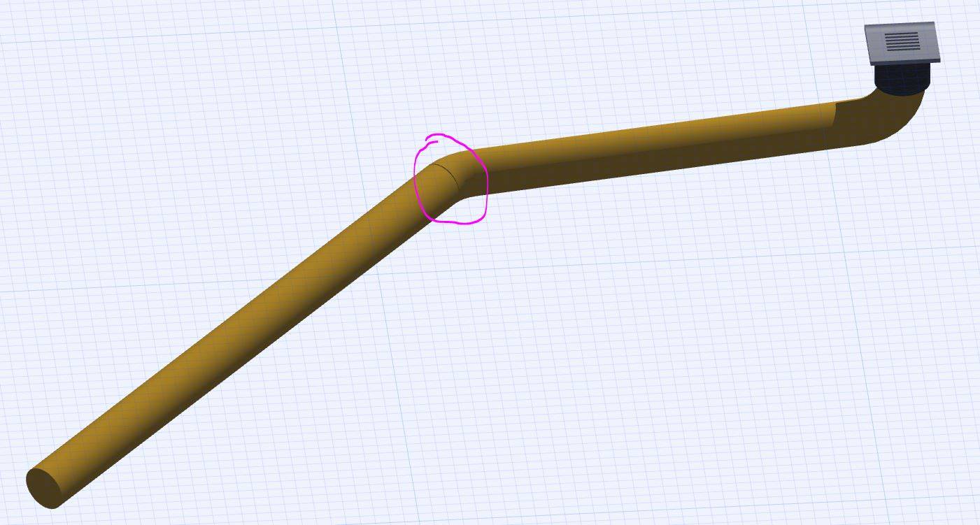

The falling pipe programm includes pipes at varaible lengths, followed by corners or bends at variable angles, in the same fall slope.
Each item (pipe or corner) starts at a coordinate point, then with the given slope and angle calculates the exate end point coordinates in x,y and z, to connect the next item to.

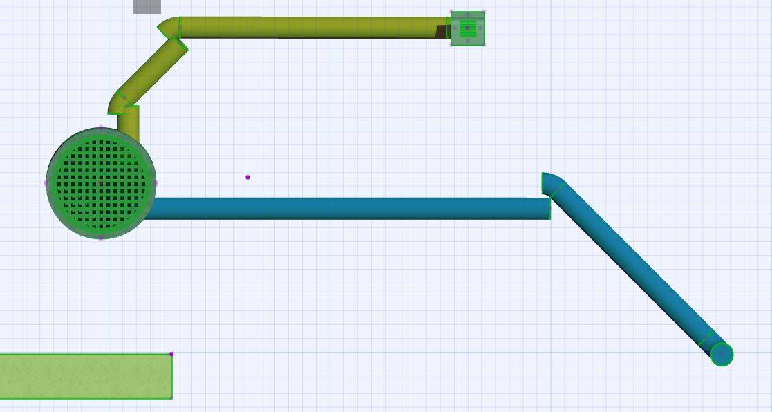

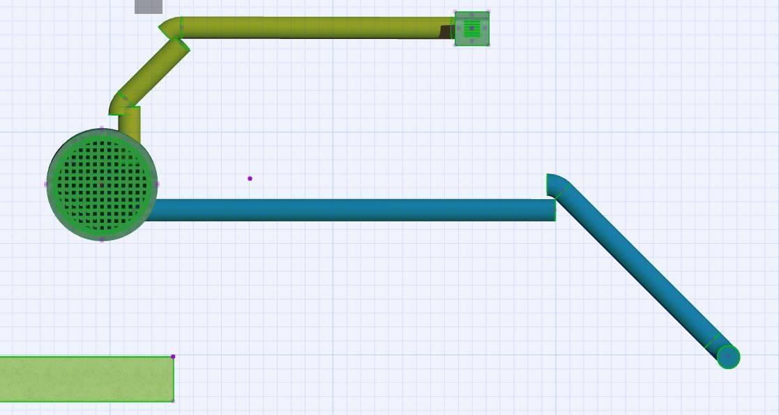

The normal straight pipes are no problem, but I am having trouble calculating the exact end point of the corners.

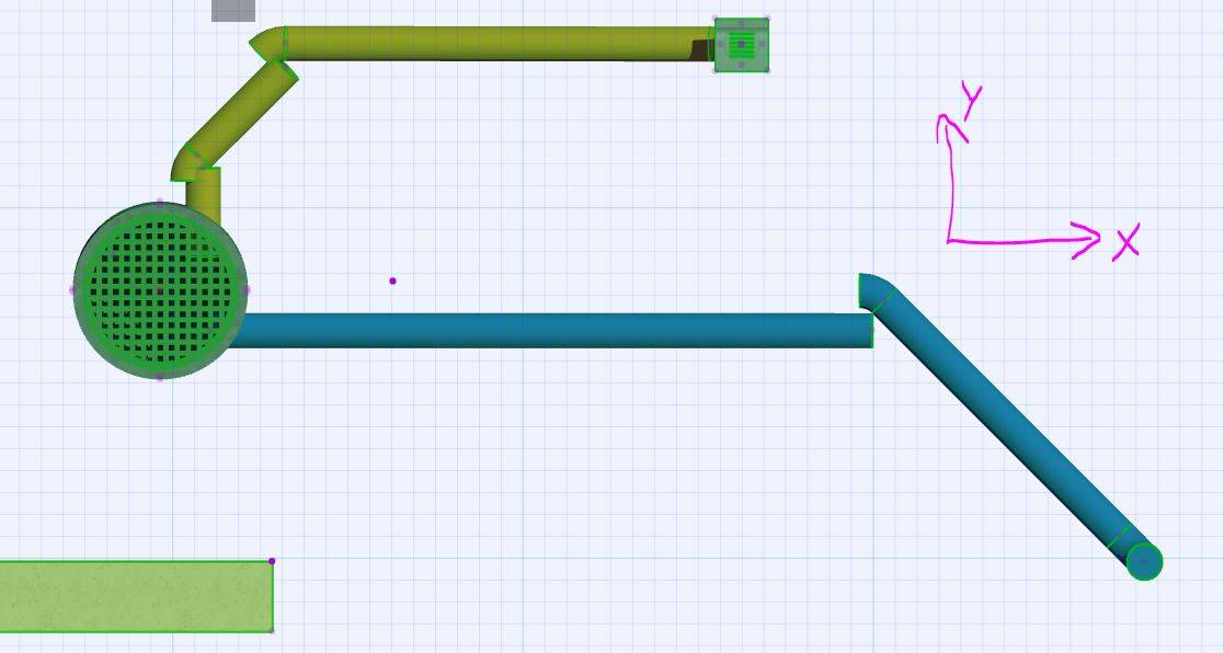

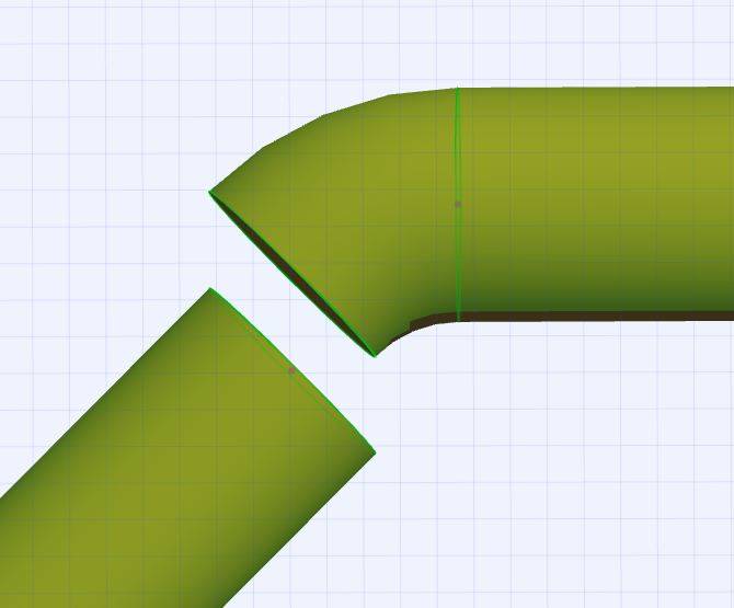

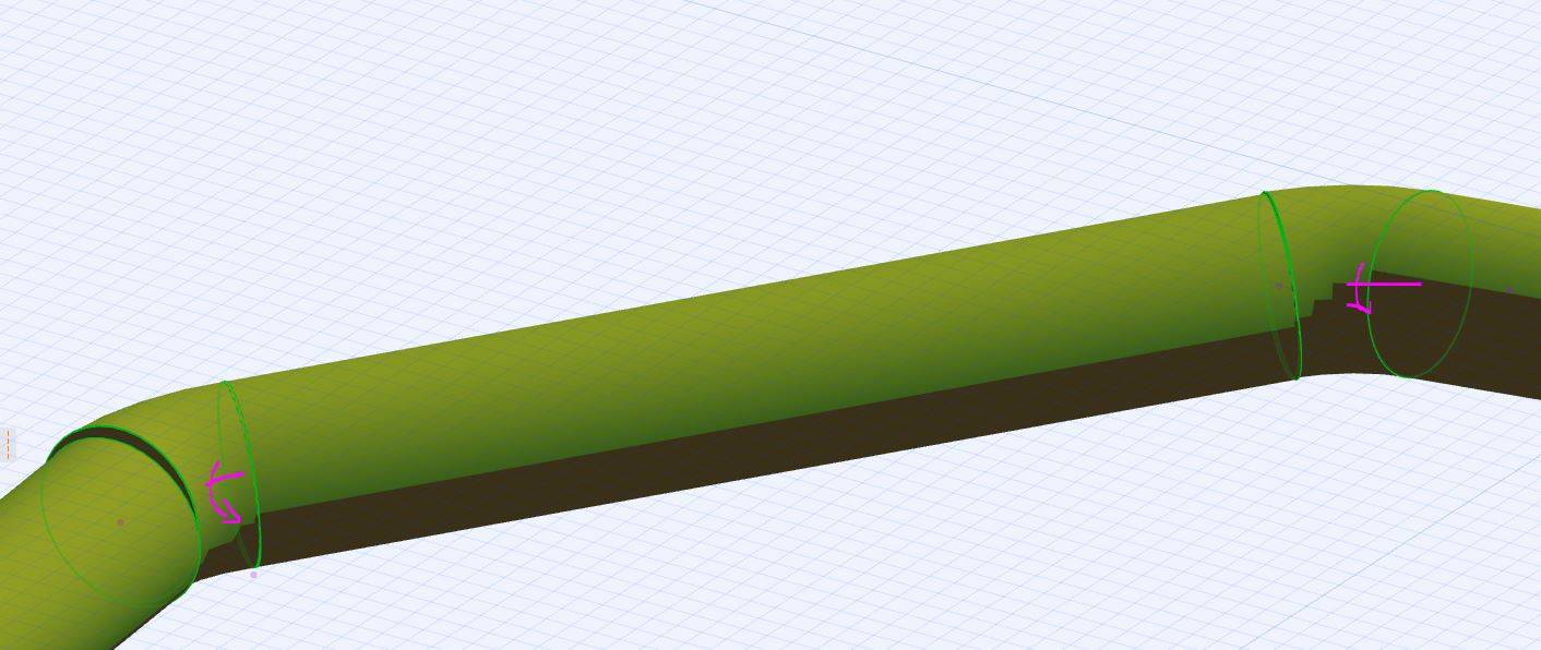

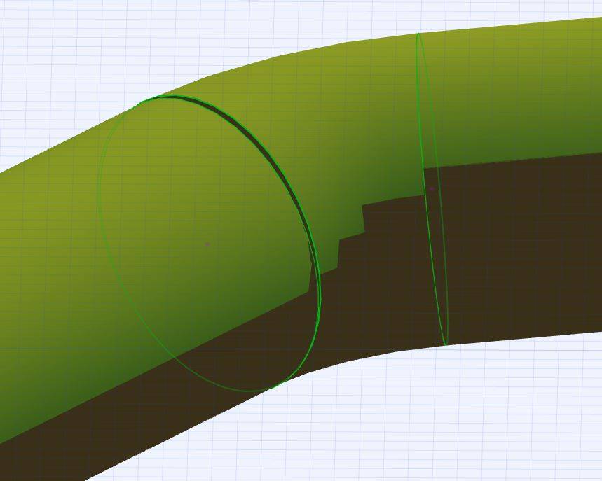

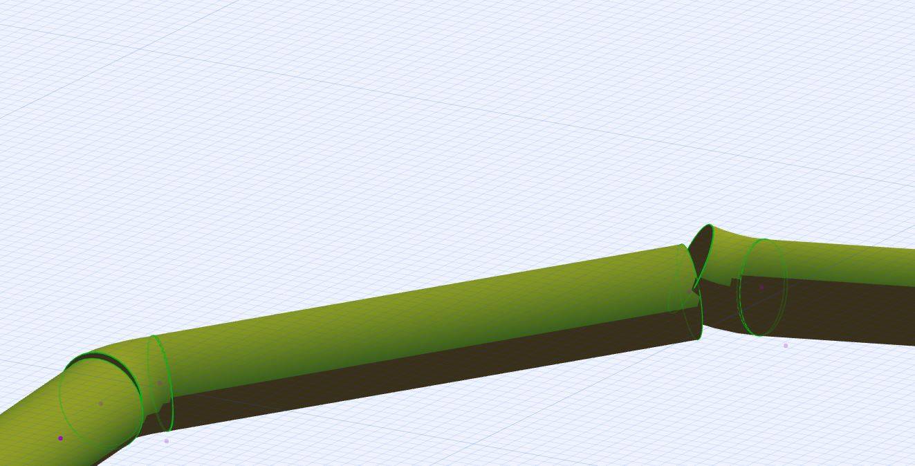

Here are images showing the current results of my programm (Notice the offset of the last connecting pipe to the 45 degree corner piece)
Here is the code of the corner item. I tried to comment it as good as possible and hope that it is self explanatary. If something is unclear please feel free to ask me.
Just to clarify, it is the returned coordinates that are not quite right RET_X,RET_Y and RET_Z. I suspect it has to do with the fall in the corner that i can't quite figure out.

Thanks to anyone who can relieve the current pressure on my brain and help me finally figure this out!

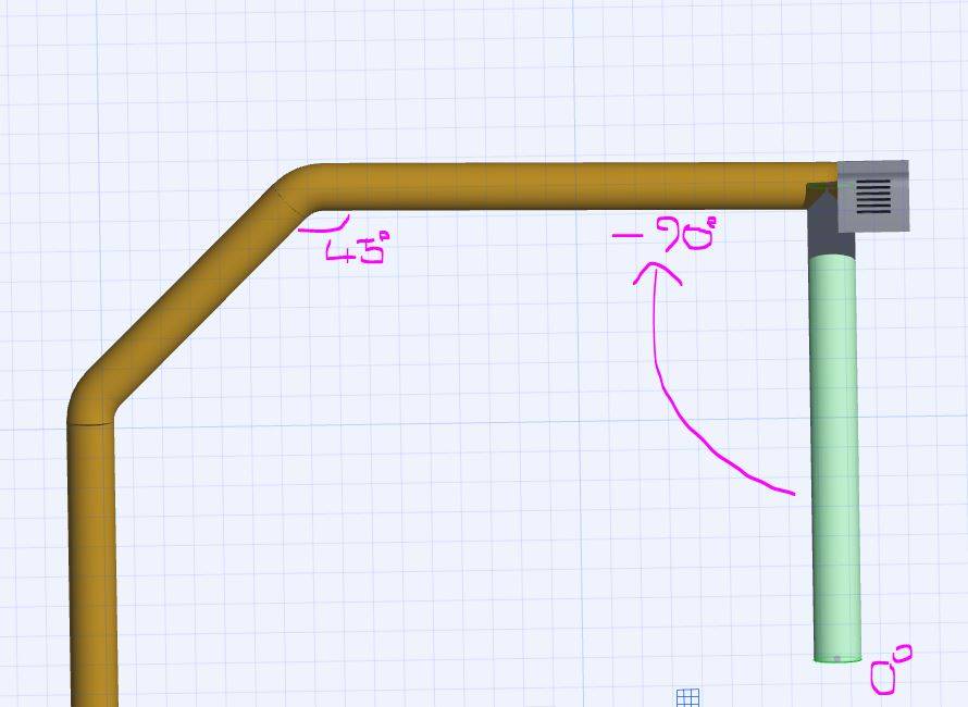

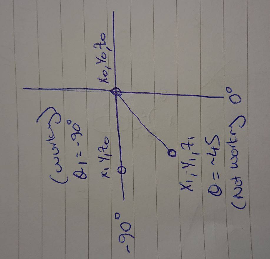

So backing up a little, What would be the formula to find the end point displacements of x1,y1 and z1 from x0,y0,z0 of vector v, with known parameters θ2 and length v?
I was using:
y1 = y0-(v * COS(θ1))
x1 = x0-(v * SIN(90-θ2))
z1= z0-(SIN(-θ2)*v)
where θ1 was the angle of the pipe in relation to the y-axis and θ2 the fall slope of the pipe.
This seemed to work when θ1 was -90deg (as shown in the images above) but if it is say -45deg then it is not working :(View attachment 8576If you can help me in these terms, so i can find the separate coordinates, then I would be extremely happy...otherwise i may have to give up :(
Thank you so much for your time and patience
Regards
Brent

That's an unconventional choice for θ1. Anyway, if you mean what I think you mean with θ1, we have:
\begin{cases}
x_1= x_0-v\sin\theta_1\cos\theta_2 \\
y_1=y_0+v\cos\theta_1\cos\theta_2 \\
z_1=z_0-v\sin\theta_2
\end{cases}
Klaas you are a genius!
Thank you so much, that works perfectly... had to adjust a little to:
x1=x0+vsinθ1cosθ2
y1=y0-vcosθ1cosθ2
z1=z0−vsinθ2...Dont ask me why but that works perfectly now!

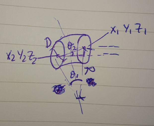

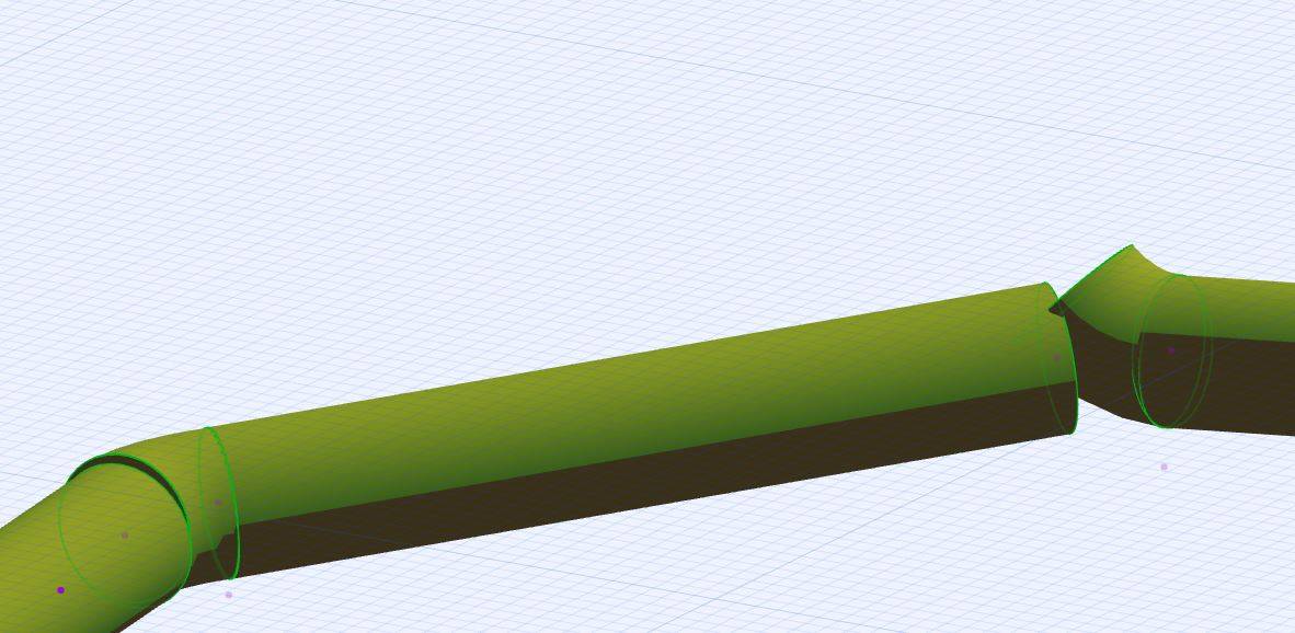

Hi Klaas,
So given the following diagram:
X1,Y1,Z1,θ1,θ2 and R are known parameters
θ1 is the angle of the corner
θ2 is the falling slope in the z axisAfter reading the wikipedia link you sent and trying to apply the last formluars you gave i tried:
X2=X1-R*SIN(θ1)*COS(θ2)
Y2=Y1-R*SIN(θ1)*SIN(θ2)
Z2=Z1-RCOS(θ2)
And Also:
Y2=Y1-R*COS(θ1)*COS(θ2)
Z2=Z1-RCOS(θ2)The later giving this result:
I also tried switching the angles over
Unfortunately nothing worked.It looks like the Z axis is good. can't tell for sure until i get the x and y coordinates right though.
Can you help me out on this basis?
Thanks!
PS in the above applied example,
θ1 is 45deg
θ2 is 2 percent fall
R is 0.1m

Hi Brent,
I have some trouble understanding what your angles θ1 and θ2 are exactly in your drawing.
They are different from the angles that we used to determine the direction vector of the first pipe aren't they?
There we had that θ1 was the horizontal angle with the negative y-axis (similar to longitude).
And θ2 was the downward angle (similar to latitude down).
Can it be that in the elbow drawing:
- θ1 is a horizontal angle as well, and represents the increase in the original θ1?
- θ2 represents the increase in the original θ2?
If so, I'd like to call them $\Delta θ_1$ respectively $\Delta θ_2$ to distinguish them from the previously used angles, and to indicate that they are changes in those angles.
Before I set up any formulas, can you clarify?
Hi Klaas,
Sorry for the lack of clarity.
Yes that would be correct...could also be a decrease, if the corner goes in the other direction. But let's just get it right for this example, then i hope to be able to figure out how I can adjust.
This is the same axis, but stays the same value, so no increase. it would be the same as the original θ2. (Slope fall of the piping system which is constant through all elements)
Sure that would make sense to give these angles other names.
Thanks for your help!
Regards
Brent
Hmm... this gets a little complicated...
I get:
$$\mathbf x_2 = \mathbf x_1 + \frac R{\|\mathbf{\hat v} \times \mathbf{\hat w}\|} \Big((\mathbf{\hat v} \times \mathbf{\hat w})\times(\mathbf{\hat v} - \mathbf{\hat w})\Big)
Or split up:
\begin{cases}v_1 = \sin\theta_1\cos\theta_2 \\ v_2=-\cos\theta_1\cos\theta_2 \\ v_3 = -\sin\theta_2\end{cases}
\begin{cases}w_1 = \sin(\theta_1+\Delta\theta_1)\cos\theta_2 \\ w_2=-\cos(\theta_1+\Delta\theta_1)\cos\theta_2 \\ w_3 = -\sin\theta_2\end{cases}
\begin{cases}c_1 = v_2w_3-v_3w_2 \\ c_2=v_3w_1-v_1w_3 \\ c_3 = v_1w_2 - v_2w_1\end{cases}
$$c = \sqrt{c_1^2+c_2^2+c_3^2}$$
\begin{cases}d_1 = v_1-w_1 \\ d_2=v_2-w_2 \\ d_3 = v_3 - w_3\end{cases}
\begin{cases}e_1 = c_2d_3-c_3d_2 \\ e_2=c_3d_1-c_1d_3 \\ e_3 = c_1d_2 - c_2d_1\end{cases}
\begin{cases}x_2 = x_1 + \frac Rc e_1 \\ y_2 = y_1 + \frac Rc e_2 \\ z_2 = z_1 + \frac Rc e_3\end{cases}

Hi Klaas,
Unfortunately I am still struggling with this. I have tried using your given formula, and also tried in various different ways altering the +- to see what results I get.
Your formula applied to this object and pipe systems is giving me this result:
Is it possible that there is some error in the formula?
Here is what I am using with the actual values for corner "A" put into the formula instead of variables:
Code:
		v1=SIN(45)*COS(-2)
		v2=-COS(45)*COS(-2)
		v3=-SIN(-2)
		w1=SIN(45+-90)*COS(-2)
		w2=-COS(45+-90)*COS(-2)
		w3=-SIN(-2)
		c1=v2*w3-v3*w2
		c2=v3*w1-v1*w3
		c3=v1*w2-v2*w1
		c=SQR(c1^2+c2^2+c3^2)
		d1=v1-w1
		d2=v2-w2
		d3=v3-w3
		e1=c2*d3-c3*d2
		e2=c3*d1-c1*d3
		e3=c1*d2-c2*d1
		x2=((0.1/2)/c)*e1
		y2((0.1/2)/c)*e2
		z2=((0.1/2)/c)*e3
The actual returned values are:
x1 = 0
y1 = -0.0706683
Z1 = 0.0019988
Any ideas? (Thinking)
  • Top-down 2D diagram of a pipe layout: a green-yellow pipe with an elbow leads from a circular perforated vessel to a horizontal run ending at a small square fitting, and a blue pipe runs horizontally from the vessel then bends down-right to an open end.
  • Top-down 2D CAD view of a pipe system: a circular pump with a grid-patterned face, olive piping routed up and across to a box fitting at top right, and a blue pipe running right then angling down to a round outlet at lower right. Magenta X and Y axes are drawn at upper right.
  • Top-down CAD view of a pipe system: an olive pipe with a bend labelled A and a circled corner, a green cylindrical pump at left, and a blue pipe running right then angling down to the lower right.
I can't match your angles with your picture.
Code:
                v1=SIN(45)*COS(-2)
		v2=-COS(45)*COS(-2)
		v3=-SIN(-2)
		w3=-SIN(-2)
Which pipes are these supposed to be?
I don't see a 90 degree connection anywhere.
My best guess based on your earlier picture, is that it should be:
Code:
                v1=SIN(90)*COS(-2)
		v2=-COS(90)*COS(-2)
		v3=-SIN(-2)
		w1=SIN(90+45)*COS(-2)
		w2=-COS(90+45)*COS(-2)
		w3=-SIN(-2)
Would that fix your problem?

Hi Klaas, Sorry I've been on the road the last couple of days.
Just picked this up and yes your guess was pretty much right.
This seems to give me the right coordinates:
Code:
			v1=SIN(-90)*COS(2)
			v2=-COS(-90)*COS(2)
			v3=-SIN(2)
			w1=SIN(45-90)*COS(2)
			w2=-COS(45-90)*COS(2)
			w3=-SIN(2)
To answer your questions... I hope :)
This is where i was getting my angles from:
Btw, I notice that you have c=SQR(c1^2+c2^2+c3^2).
Is that SQR a square or a square root?
It has to be a square root, which is usually denoted as SQRT.
... The Program coding in GDL uses "SQR" for Square root, so should be good.
I seem to be missing (x1,y1,z1) in there. Or did you pick them to be zero?
Well actually I am saving the end point of an object as the current (local) coordinate each time i place an object, so the next object gets placed at 0,0,0

  • Diagram of a pipe run in 3D: a horizontal segment at the top with a vent at its right end, a 45 degree bend, and a vertical segment on the left. A green vertical pipe drops from the vent, with a pink annotation showing a -90 degree rotation and a 0 degree label.
Unfortunately the new calculations have aired a new challenge.
It seems I am not quite getting the X rotation quite right.
The calculated end coorddinate from your formula now looks good, but it seems i haven't taken everything into consideration in rotating the corner correctly.
This is the result using your new formula for the "endpoint" of the elbow...which is seen actually as the starting point of the next pipe. WHich is correct. Using a rotation angle in the X-axis of 90degrees I get this:
To Illustrate how this rotation in the x-axis is working, here are some axamples. The first is rotation 0degrees, the second 45degrees:
By trial and error I get it about right on this corner by increasing by 4degrees, So 94degrees is nearly right. (NOTE... I nearly forgot... In these examples i was using a fall slope of 10 degress instead of 2degrees to make it show more clearly, so "94 degrees" would be nearly right with a fall slope of 10 dgerees , not 2 as in your last formula)
Notice though, using the same corner code, the second corner is further out...
What do you think. Is this going to be too hard to manage or do you think you may be able to find a solution to calculate the correct X-axis rotation angle? (The same parameters are available to calculate with as in the previous example...(Whew) (Smile)
  • 3D model render of a green pipe run with two elbows on a sloping grid, with green circular end outlines and magenta rotation arrows at each joint.
  • 3D render of a green pipe system on a grid background, with a straight pipe section, a corner elbow at the left end and a second bend at the right, showing pipe ends outlined in green.
  • 3D render of a green pipe run with two elbow bends, showing a misaligned joint at the second corner where the next pipe section is offset from the first.
