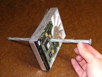

Pengwuino said:
Why drill holes into it? I mean, if you want to start talking power tools, then sure, drill a hole, go at it with a hammer, grab a saw, whatever.
How I keep my farm animal porn from falling into the wrong hands.
