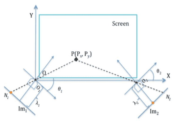

Hi all so I plan on using the following method for my display. I might add a third camera to increase the accuracy and allow multitouch. I think that using scanning line cameras relatively low end should do the trick and avoid using a lot of wiring and connection unlike using IR-receivers.
Is it possible to output the image of the camera as a binary signal... i.e areas where the finger can be detected would output 1 and background would output 0 ? If not I will have to do some image processing which I'm not sure is an easy thing to do.
Figure 1: Coordinate System for Pointer Locater Using Stereovision
The original position of the pointer can be found by solving:
Where:
Where: d2x ; d2y are the coordinates of the focal point of the right camera
Dividing the original position by the pixel size of the display yields the cursor position of the pointer.

What I hope is to have a camera that "sees" a 1 pixel thick layer above the display. The field of view of my line scan camera is parallel to my display (side view). The idea is that after calibration the camera outputs a value of 0 for each pixel, say 00000000000000000. But when a finger touches the screen the pixel value change for some pixels, say 00135310000000000. I can therefore deduce that my finger is located where the 13531 is, i.e to the left of my image. The centre of my finger is located at the pixel with a value of 5. I can then work out the distance between the centre of my image (in the image above I've got 17 pixel, so the centre of my image is the 9th pixel , so my finger is offset by 3 pixels from the centre of my image (see N values in the sketch).
