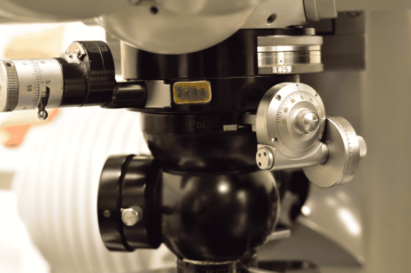

Sometimes I win at eBay:
Close-up photo of a black polarizing microscope fitting with a silver rotating dial scaled in degrees, a yellow label reading Pol, and a fine-adjustment micrometer knob on the left.
On the right is a Ehringhaus quartz compensator in perfect condition- I believe the seller didn't know what they had, I got it for $200. Now I need to learn how to use it :)

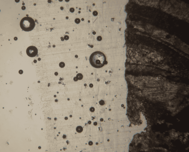

One thing I don't understand are the presence of small flakes of "something", I think part of the sample prep- these are uncovered and non polished sections. The flakes are uniform size, square, and highly birefringent. Two views, one with parallel polarizers and the other with crossed polars:
Photomicrograph of a thin section in plane-polarised light showing dark circular bubbles or inclusions scattered across a pale grey mineral field, with a dark, textured fossil or rock region on the right.

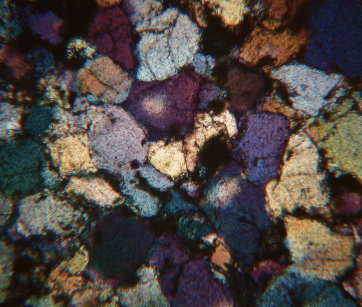

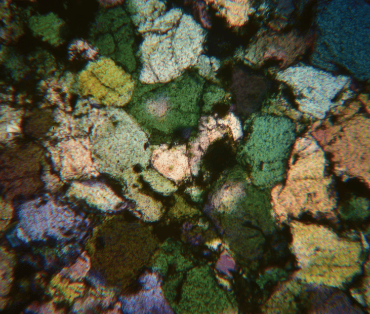

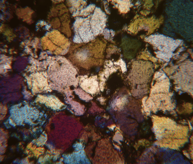

And using the compensator on a cemented sandstone sample from the Crigglestone Rock Formation (Carboniferous) gives the following sequence as the compensator retardation changes from 0 to (I think) +1λ, based on a rotation angle of 30 degrees:
Thin section photomicrograph under crossed polarized light of densely packed mineral grains in a sandstone, showing bright and dark interference colours in varied hues.
Photomicrograph in cross-polarised light of a sandstone thin section showing densely packed, angular mineral grains in bright interference colours of pink, yellow, blue, green and magenta against dark matrix.
Thin section photomicrograph under crossed polars showing densely packed mineral grains in vivid interference colours of pink, blue, yellow and green, with dark grain boundaries and cement between them.
Thin section photomicrograph under crossed polarized light showing densely packed mineral grains in varied interference colours, with dark extinction areas between them.
Not sure what these minerals are... any guesses?
I tried to get some interference figures, but nothing was 'clean' enough.
Maybe cubes of crystal grit, (embedded in the Canada balsam cement which has the same RI as the glass slide).
I remember the 1970s, when petrology could always be bright and colourful, no need for hallucinogenics then. At the time, I felt the rocks knew more about me, than I did of them. Handheld XRF has ruined that game.

The next sample I worked with is from the Dneister Formation (Devonian)- here's when I start to move beyond 'hey, cool pics!'. Here are a couple grains of something, in two different rotation orientations with respect to the crossed polars at 16X:Not sure what these minerals are... any guesses?
As far as I understand it, these sections are fossiliferous. These sections are usually thicker than petrographic sections, which makes identification of the mineral content far more difficult.
You should try to determine the thickness of your sample. To this end, use a rather highly magnifying objective (40 or 50) and focus on the upper and lower side of your sample. The fine drive should be gauged in mum on your microscope. Take the difference and multiply by the approximate index of refraction of your sample (usually 1.5). You can then determine the maximal interference colours from a Michel Levy chart (https://www.researchgate.net/publication/242341440_extended_chart).
Are these slides covered? Petrographic analysis requires the slides to be grinded (but not polished) and covered, to be able to judge e.g. the "chagrin", which allows for estimation of the index of refraction.

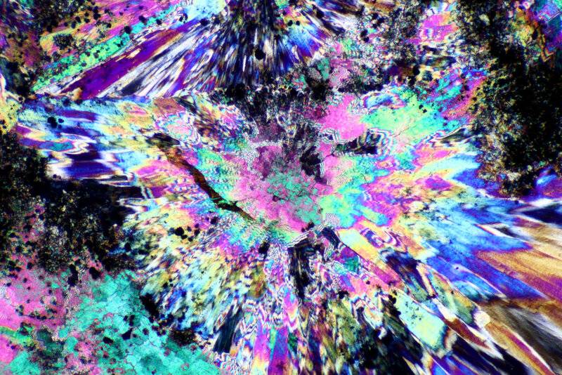

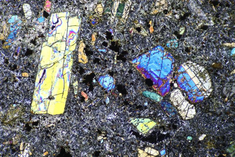

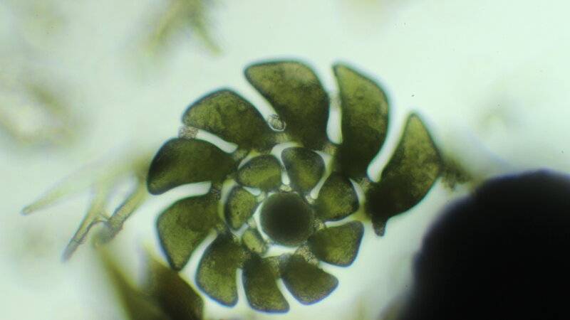

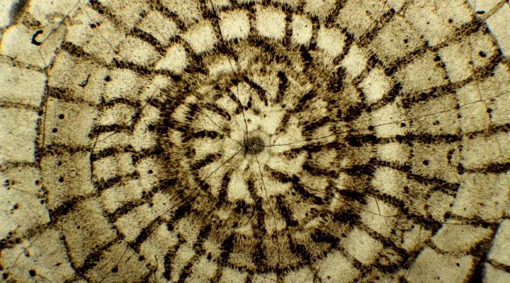

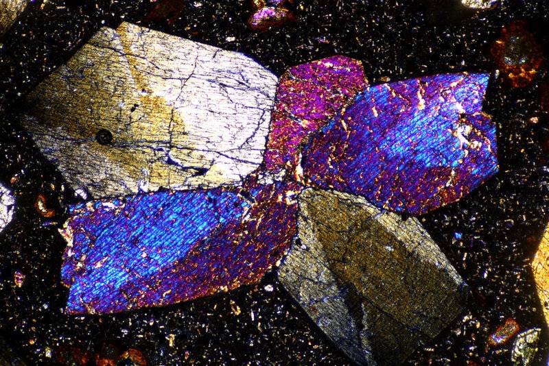

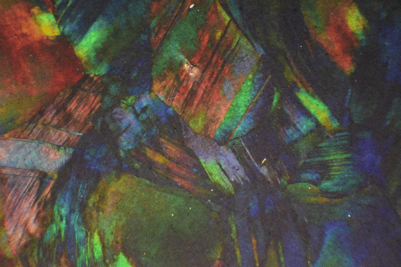

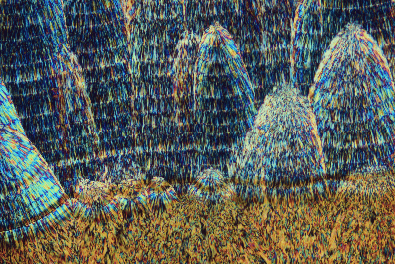

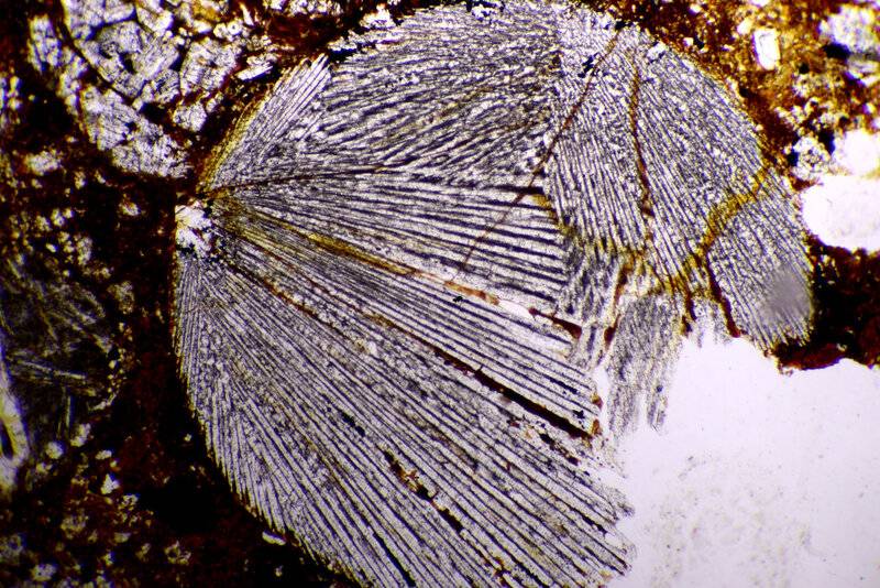

Here some pictures:
1. Prehnite, Norway
2. Essexite, Kaiserstuhl Volcanoe, Germany
3. Nummulith, Bad Adelholzen, Germany
4. Nummulith, Glauconitic filling after treatment with HCl. Bad Adelholzen
5. Limburgite, Limberg, Germany
6. Chondrite, North Africa
I just realized that the photos are not always shown in the same order. So consider this to be a quiz!

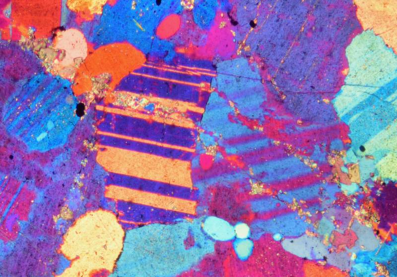

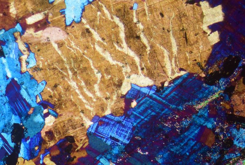

I received a bunch of thin sections originating from the Fen Complex, I believe this one is a carbonatite, specifically søvite:
Thin section photomicrograph under crossed polarised light showing a mosaic of brightly coloured mineral grains, with a central grain displaying parallel twin lamellae in orange and purple bands.
I also found crystals showing cross-hatched twinning but couldn't get a decent image (for now).

The cross-hatched mineral is probably microcline. In the left corner maybe some plagioclase.

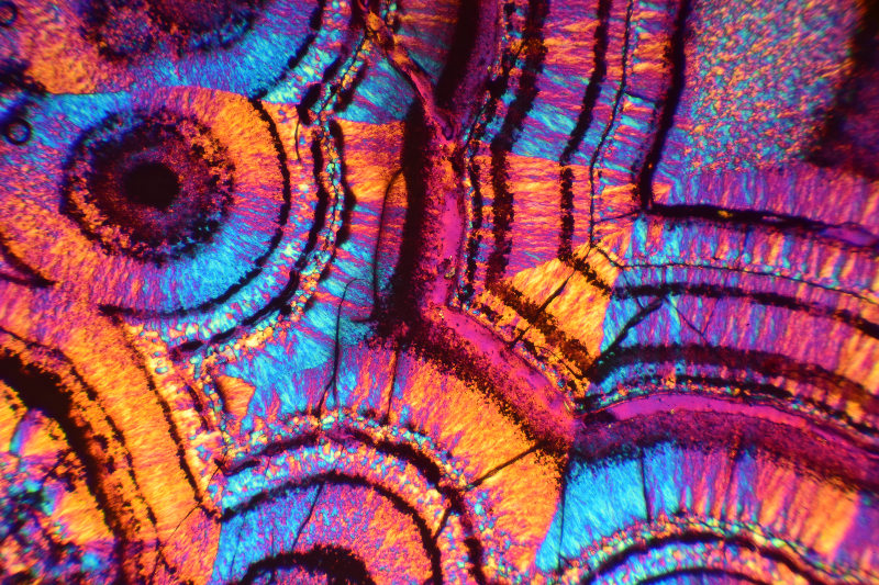

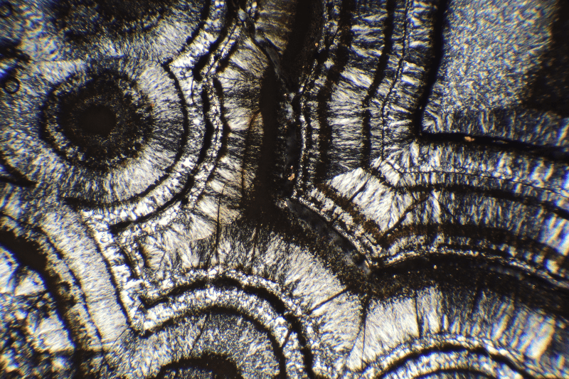

Some samples I sent out for thin sectioning came back- I'm really pleased with how they came out. Here's agate at 4x (crossed polars and then crossed polars + 1λ waveplate)
Photomicrograph of agate thin section under crossed polarized light, showing concentric banded rings of fibrous quartz with dark extinction bands and radiating crystal fibers.
Photomicrograph of agate thin section under crossed polarized light, showing vivid blue, orange and magenta interference colours in concentric banded and circular growth patterns with dark cracks.

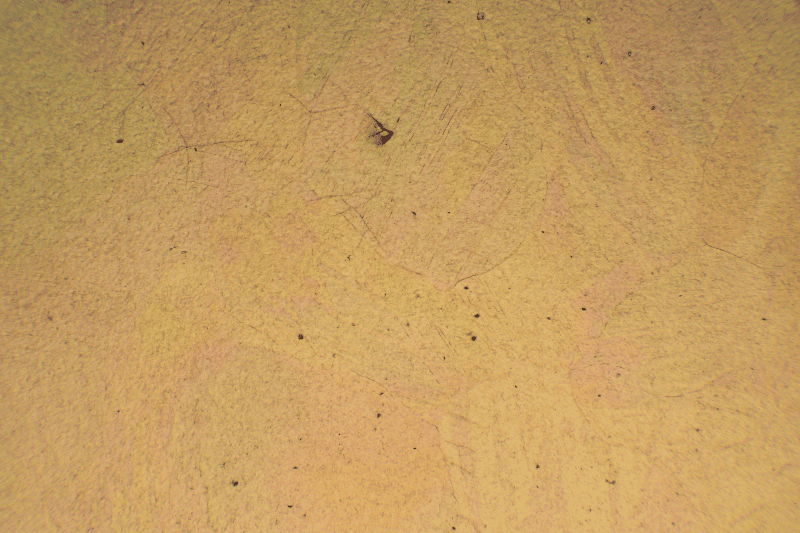

And here's opal, first at 4x: no polarizer, and then crossed polars:
Photomicrograph at 40X, no polarizers, of a yellowish-pink opal surface with fine scratches and a few dark specks, no clearly resolved spheres visible.
Photomicrograph at high magnification of opal showing iridescent patches of red, green, blue and orange against a dark background, with fine diffraction-colored structures.
The colors come from diffraction, not birefringence. Using a 1λ plate turns the field a uniform purple-red color.
