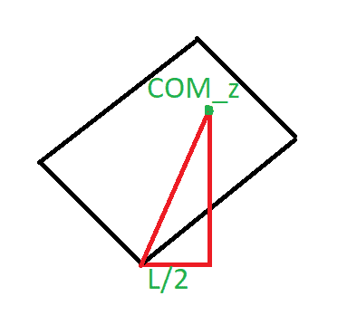

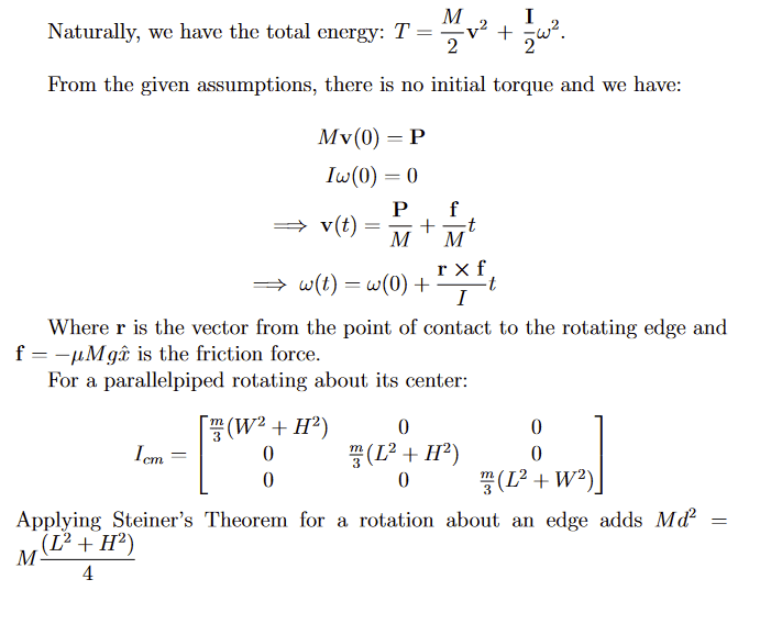

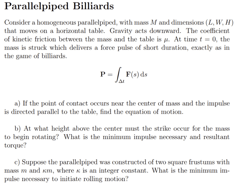

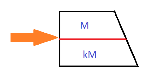

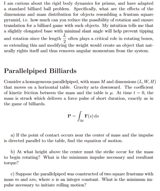

Consider a rectangular prism struck by a cue, what are the resulting dynamics if the object has two continuous mass distributions and the base height is longer than the top height?
Impulse, Torque, Total Energy, and Euler-Lagrange.
I plan to add on to this as I have time and ability. Apologies for the weird formatting.
Typeset paragraph of text reading 'I am curious about the rigid body dynamics for prisms', ending with the fraction L/2 and the sentence about objects that naturally right themselves.
Tilted rectangle with a green dot labelled COM_z near its top edge and a red right triangle from the lower corner to the dot, with the horizontal leg labelled L/2.
Diagram of a trapezoid-shaped block split by a horizontal red line into an upper part labelled M and a lower part labelled kM, with an orange arrow pointing at the left side on the red line.
Printed problem sheet titled Parallelpiped Billiards: a homogeneous parallelpiped of mass M and dimensions (L, W, H) on a table, impulse P = integral over delta t of F(s) ds, then parts a) to c) on equations of motion, strike height and rolling impulse.
Printed question text: d) What dimensions, and slant angle, for the compound frustum will maximize the impulse necessary for rolling motion?
Typeset physics derivation: total kinetic energy T = (M/2)v² + (I/2)ω², initial conditions Mv(0) = P and Iω(0) = 0, solutions v(t) = P/M + (f/M)t and ω(t) = ω(0) + (r × f/I)t, moment of inertia matrix of a parallelepiped about its center, and Steiner's theorem term Md² = M(L² + H²)/4.
