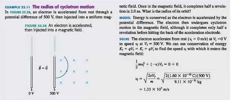

Textbook page showing Example 33.11 on the radius of cyclotron motion, with Figure 33.3a of an electron accelerated from 0 V to 500 V and Figure 33.3b of it entering a region of crosses marked B = 0 and into a magnetic field, plus worked solution equations for speed.
conservation of energy
how can the energy at the beginning be zero. then get accelerated?
umm proton goes to lower potential and electron goes to higher potential? correct?
i think that electron gets pulled by the higher potential surface correct?
can some one explain
The field between the plates exerts a force on it.
Yes
