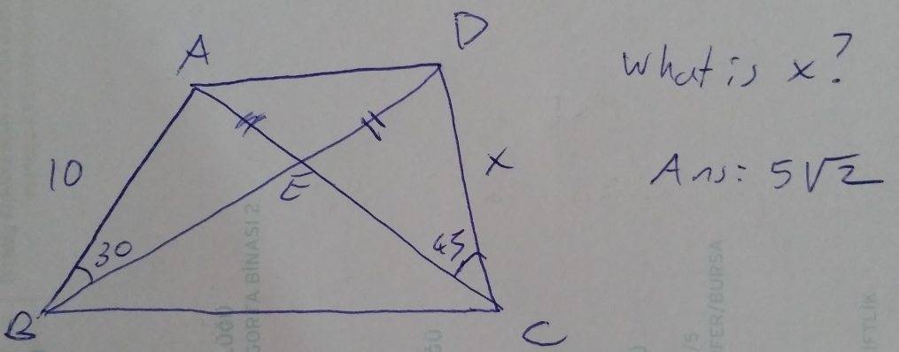

Hello,
What is the value of x in the attached?
obviously angle EAD = EDA but then what?
the shape is irregular. View attachment 8599

ketanco said:
Hello,
How about using the sine rule, also known as the law of sines?
