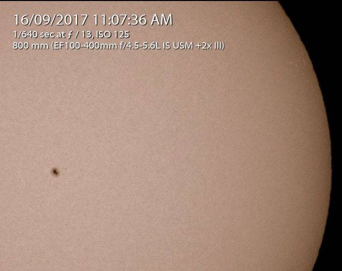

16 September 2017
a single spot group is currently visible
but I did capture some bright faculae near the limb in the upper right of the image
This is with my new solar filter film from Baader
Solar photograph showing the sun's disc with a single small dark sunspot on the left side, with a timestamp reading 16/09/2017 11:07:36 AM and exposure details in the upper left corner.

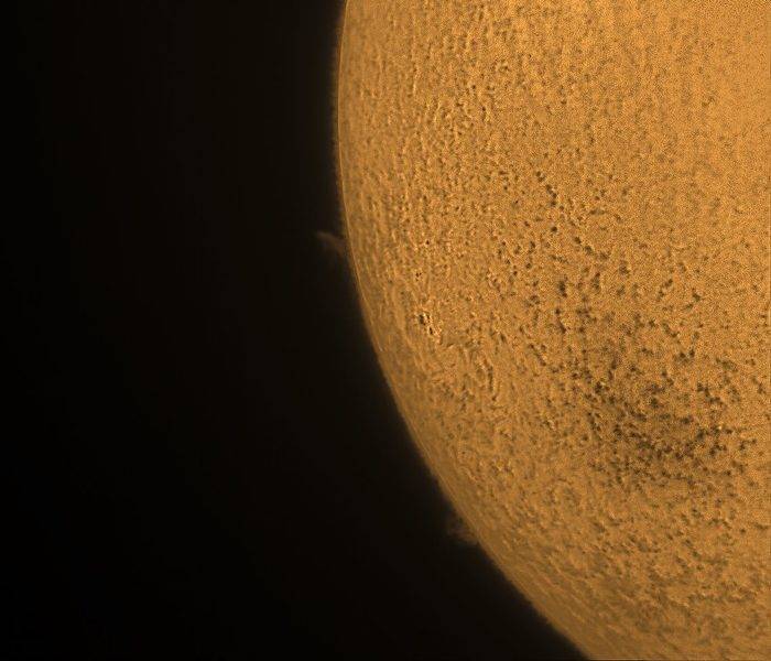

I took this one about a year ago. Not too much happening here but I think the image came out well.
Hydrogen-alpha view of the left limb of the Sun against a black background, showing a mottled orange chromosphere with dark filaments and a small prominence at the edge.
good shot, thanks for sharing and I hope to see more :smile:
what solar scope/filter system are you using ?
Dave
Dave
Thanks!
The scope is a Takahashi 90mm with a Coronado Ha filter. The image was taken with an ASI120. The image was created using lucky imaging and wavelet filtering.
