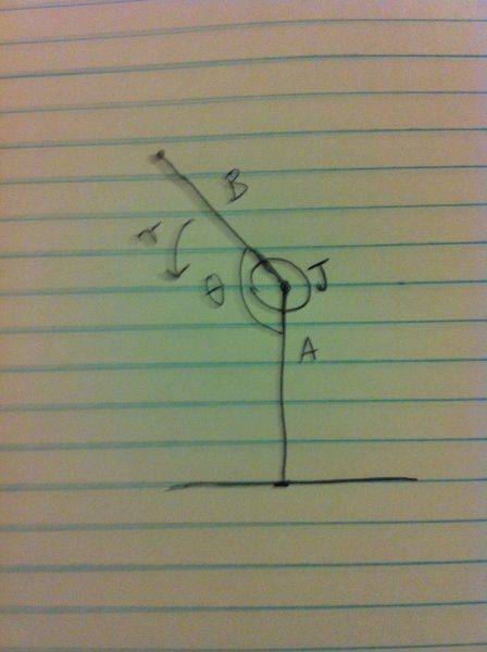

Hi guys, I am attempting to experimentally measure torque from two rods connected to a servo. Let's say rod A stays fixed, and the servo, mounted at the end of rod A (at joint J) moves rod B to a certain angle θ with a velocity v. In addition to velocity and angle, I also know that the servo is powered with a constant 5 volts, and in my measurement circuit I'm also measuring the current. Therefore I should know the instantaneous current (I) resulting from any force that opposes the movement of rod A. Also, let's say I can measure the mass and length of rod A, but I would prefer if I didn't have to do that. I hand-drew a picture to try and make this a bit more clear, but please let me know if I need to elaborate at all (I'm not very familiar with servos really, and physics isn't quite my thing).
Hand-drawn sketch on lined paper of a servo joint J at the end of fixed rod A, with rod B angled from it, labelled theta, and a curved arrow labelled tau showing rotation.
I'm thinking I may need power, but a friend told me I may also need moment of inertia (let's call it IA). So I'm not quite sure, but I think these are important:
P=IV
IA=∑mr2
τ=rFsin(θ)
I was thinking that if I could obtain a profile for power, I could integrate to get the work, and somehow get torque from that. This is where I'm stuck though. I would really appreciate any help someone could provide me, even if it's just some direction. Is there something I'm not taking into account? What's the easiest way of doing this? Are there multiple ways?

Hi CWatters, thanks for sparing your time with a response-I'm still struggling with this problem.
I don't think I explained this well. Both rods will not be moving. You can pretty much imagine rod A being some fixed wall or surface. Only rod B will be moving. In reality, rod A is connected to rod B and via a mechanism I won't get in to; however rod A stays stationary throughout. In the final design, there will be a force that will actually resist the motion of rod B (basically resisting the servo), which is why I'm interested in calculating torque via the parameters I listed. And, yes I am very interested in speed vs torque. Although I'm using a pretty strong servo, I do think the arm will have "significant" mass (around or over 4-5 kg). Let me know if you think I'm not being clear about anything. For reference, I'm currently using an Arduino to control the servo.
Would there be any way to calculate torque from these variables? Are there multiple ways, perhaps? Thanks.
Edit: Thinking about it again, using the length shouldn't be a big deal. Perhaps not the mass either.

I think I can track the instantaneous acceleration by taking the derivative of velocity.
If the mass wasn't a significant factor, would there be a way to do this just by using velocity/Power/angle etc..? Or another way? I may need an alternative.
If the mass of the rod is very small the torque will also be very small unless there is another load? eg the rod is pulling something?
Another way to estimate torque would be to measure the current..
PowerOut = Efficiency * PowerIn
PowerOut = TorqueOut * AngularVelocityOut
PowerIn = Current * Voltage
So..
TorqueOut * AngularVelocityOut = Efficiency * Current * Voltage
rearrange..
TorqueOut = Efficiency * Current * Voltage / AngularVelocityOut
The big unknown is the Efficiency. However you could try applying a known torque (eg a load) and measure everything else to calculate the efficiency.
