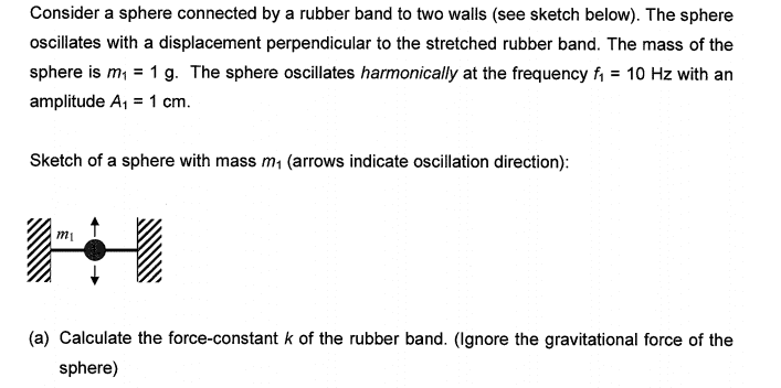

I would appreciate help on this problem.
f = (1/2L)*sqrt(F/u)
This is vibrating at its fundamental frequency so L = (wavelength/2). To find k I reckon I need to find the force on the band and this should equal -kx. But I don't have the length of the string or the mass density. Is there a formula I am missing or something or what ?
Edit; or possibly it has something to do with this y = 2 Asin(kx+ot)sin(wt+ot). o is phase angle.
Thanks!

… I don't have the length of the string or the mass density. Is there a formula I am missing or something or what ?
Don't forget you only need the "y" component of the force …
that sinθ should make all the difference :wink:​

Thanks for replying.
The y coordinate is the force in this formula f=1/2l * √F/u is it not ?
If so I want the force along the elastic which is this force divided by sinθ and sinθ is 1/L and the L's don't cancel so I still can't work it out ?
