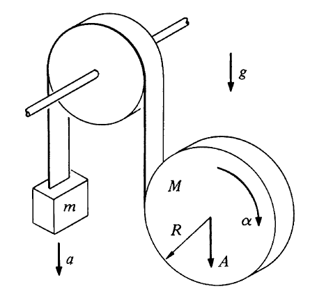

A disk of mass M and radius R unwinds from a tape wrapped around it. The tape passes over a frictionless pulley, and a mass m is suspended from the other end. Assume that the disk drops vertically.
a. Relate the accelerations of m and the disk, a and A, respectively to the angular acceleration of disk.
b. Find a, A and ##\alpha##.
Applying Newton's second law on disk: ##Mg-T=MA## where T is the tension in tape.
For m: ##mg-T=ma##. I still need one more equation.
I am not sure but do I have to equate the acceleration along string? For instance, the point in contact with disk has acceleration ##A-\alpha R##. Does this mean, ##a=A-\alpha R##?
Any help is appreciated. Thanks!
That's about right, but be careful with the signs. Which way are you defining as positive for each variable?
I am defining downward to be positive (the direction of g). But I still don't see why there is a sign error in my equation.
There's also the question of which direction of rotation is positive. Taking that to be clockwise in the diagram, I have no problem with the A-αR part. But remember that a is upwards on this side of the pulley. E.g. suppose A=0. A positive a for the descending mass should produce a positive α, but in your equation it gives negative α.
So that means, ##a=-A+\alpha R##? This also looks incorrect to me. The clue for the answer states that if A=2a, then ##\alpha=3A/R## but if I substitute a=A/2, I get ##\alpha=3A/(2R)##. :confused:

Try to use the length (or the change in length) of the tape for another constraint.

Oh, sorry - it's me that's getting my A and a confused. Anyway, I insist that A+a = αR. Consider two special case: if m is held still then a = 0 and A = αR; likewise if the centre of M is held fixed than A=0 and a = αR.

Let ##L_0## be the initial length of tape. If the block moves down x and the disk moves down y, the new length of string is:
$$L(t)=L_0+x+y$$
Differentiating wrt time twice,
$$\frac{d^2L}{dt^2}=a+A-\alpha R$$.
What should I do with this? :confused:

Good...These are correct equations .Now what is the problem ?
The problem is that these equations do not satisfy the given clue for part a. I quote the clue from the book:
If ##A=2a##, then ##\alpha =3A/R##
What I have is ##a=-A+\alpha R##. Substituting a=A/2, ##\alpha = 3A/(2R)## which is incorrect. But if I substitute A=2a, I get ##\alpha =3a/R##. Error in the book I guess?

##\alpha =3a/R## is correct :approve:

Why are you doing all this ? This isn't required .

No...that's wrong .
What does the term d2L/dt2 represent ?
The rate of change of rate of change of length of the tape. :-p
Honestly, I don't know how to interpret it. dL/dt is the rate at which the length of string changes. I don't see how should I interpret the second derivative. :(
d2L/dt2 = αR
Now, L = L0+x+y
Differentiating twice, d2L/dt2 = a+A
and αR = a+A :smile:
