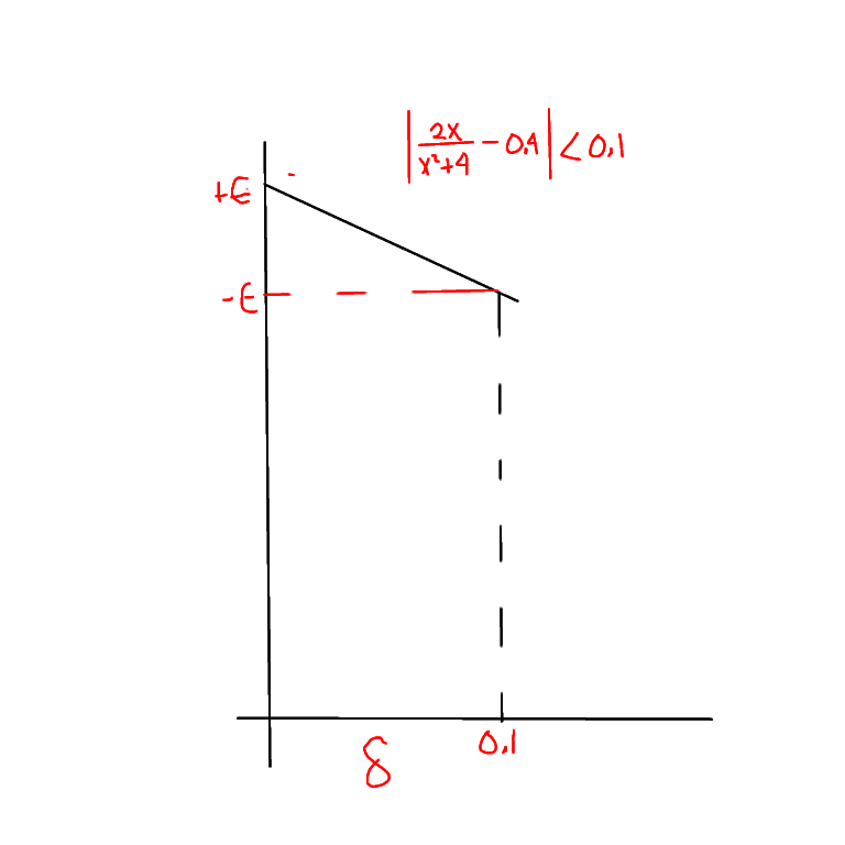

Find a graph to a number $\delta$ such that
$$\textit{if }
|x-1|<\delta
\textit{ then }
\left|\dfrac{2x}{x^2+4}-0.4\right|<0.1
ok I always had a very hard time doing these I did look at some examples but still ?
did a ibispaint drawing to start basically it looks like we are finding the dimenstions of box given the parameters
Let's draw the function $\frac{2x}{x^2+4}$.

So you are saying the transformations of $- 0.4$ and the ABS are not critical for the proof
I think I see how the rest of the calculations would go
They are relevant.
Let $f(x)=\frac{2x}{x^2+4}$.
Then we have $|f(x)-0.4|<0.1$ and $f(1)=0.4$.
It follows that we must have $0.3 < f(x) < 0.5$, and I've drawn the corresponding horizontal lines at $y=0.3$ and $y=0.5$ in the picture.
Now we need to find a minimum and maximum $x$ around $x=1$ such that the function is between those horizontal lines.
In the picture we can see that if $0.7 < x < 2$ that the function will indeed be between those lines.
That leaves finding $\delta$ such that if $|x-1|<\delta$ that we will have $0.7 < x < 2$.

Mahalo Much
I'm need to do a lot more of these to really have it down cold
I tried to make the boundary lines dashed and just up the the graph but that must be separate from the for each call?
