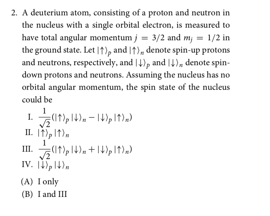

How do I understand spin in quantum mechanics for Physics GRE question 2?
jdou86
34
Summary: please help me understand the following questions from Physics GRE test Thank you very much! To be honest i really hate this formalism. Memorizing such things is pain. but like everything it is what it is
Physics GRE problem 2 on deuterium nuclear spin states: a deuterium nucleus with total angular momentum j = 3/2 and m_j = 1/2, followed by four candidate spin states I to IV written in ket notation with protons and neutrons, and answer choices (A) I only and (B) I and III.

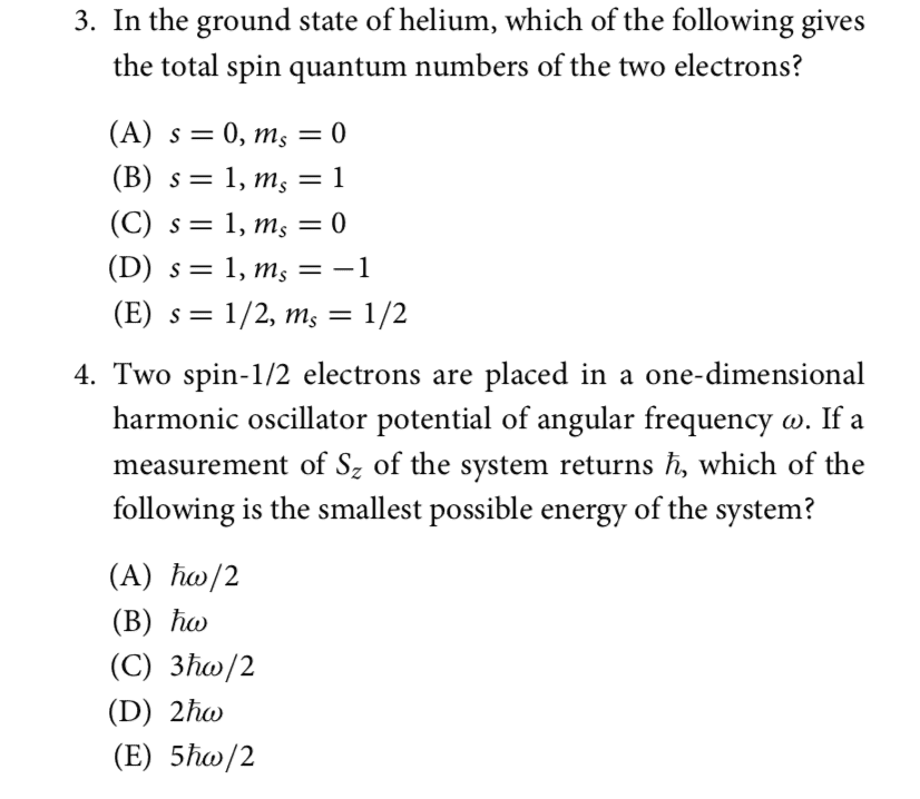

Two multiple-choice physics questions on electron spin: question 3 asks for the total spin quantum numbers of helium's two electrons in the ground state, and question 4 asks for the smallest energy of two spin-1/2 electrons in a harmonic oscillator when Sz returns hbar.

Only problem 2. I understand some part of it
I understand that for the ground state l should be 0 in total, and we can use j = l + s to do the selection. But would you mind sharing your steps so that i can learn from it?
Question 2 is about addition of angular momentum. State (1) is the singlet state which contributes zero spin for the nucleus, it isn’t a possibility since you can’t get spin 3/2 by combining a spin 0 state with a spin 1/2 state. The next three states are the triplet spin 1 states which can give spin 3/2 when combined with the electron, however the last state is ruled out by the magnetic quantum number.
