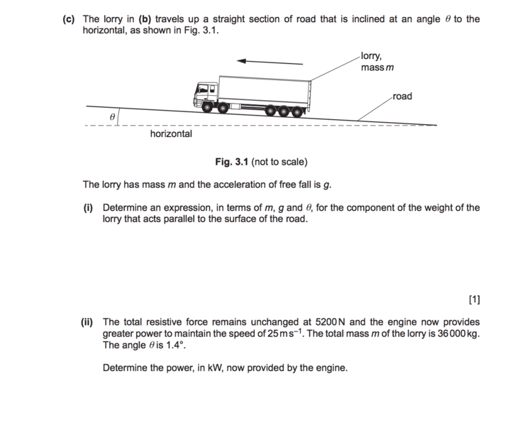

its by finding the component of weight along slope
So the slope is given, and so is the mass of the lorry. Given for you , that is.
But my telepathic capabilities are limited and I need a complete problem statement, typed out.
And: what are the directions of 8628.46 and the resistive force ?

i have attached the question image above..., is it not there? let me check again

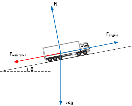

The F you need to use in P=Fv is the motive force delivered by the engine. This has to balance the opposing forces, the 5200N of resistance plus the gravitational component.

Not sure what you mean by that. In the general case the truck is accelerating, so we have ##F_{net}=F_{static}+F_{resist}=ma##, ##F_{resist}## being negative. So the engine power would be ##F_{static}v=(ma-F_{resist})v##.
