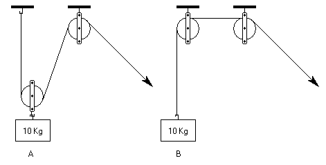

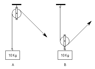

I am having trouble understanding the distribution of forces present within a pulley system; namely, how the number of sections of rope that supports an item manages to decrease the force necessary to move it.
For example, look at this picture
Two pulley diagrams labeled A and B, each lifting a 10 Kg box with an arrow pointing down-right on the rope. In A, the box hangs from a movable pulley supported by a rope running over a fixed pulley. In B, the box hangs from a single rope running over a fixed pulley to a second pulley.
I am aware that system A only requires 5 kg force to elevate while system B requires a 10 kg force; that being said, I do not understand why that is true.
Two pulley diagrams labelled A and B, each lifting a 10 Kg block: A has one fixed pulley with the rope pulled straight down, B has a movable pulley under the block with the rope pulled up at an angle.
In this picture, it would appear that both weights are supported by the same number of rope-sections, yet B requires less force to elevate.

The amount of force that the ropes exert on the mass depends on the tension in the rope and how many rope segments are pulling up on the mass. In B there is only one segment pulling up on the mass, thus the tension in the rope must equal the weight. In A there are two segments pulling up on the mass, so the amount of tension required is less.
Two pulley diagrams, labelled A and B, each lifting a 10 Kg mass; A has a fixed pulley with a rope running down to the mass, B has a movable pulley attached to the mass with the rope running over a fixed pulley.
If you draw an imaginary box around the mass (including the attached pulley in B), you'll see that B has two segments pulling up on the mass.
