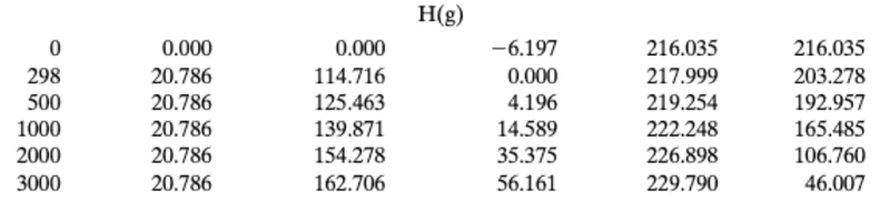

This is a problem from the book "Physical Chemistry" by Silbey, Alberty, and Bawendi.
The end of the book says the answer is ##41.572\text{kJ/mol}##.
Here is how to obtain this answer

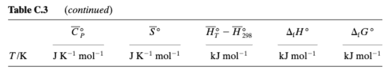

There is a table a the end of the book with the following entry
Partial table header titled Table C.3 (continued) with columns for molar heat capacity, standard molar entropy, enthalpy difference H minus H at 298 K, and standard enthalpy and Gibbs energy of formation, with units J K-1 mol-1, J K-1 mol-1, kJ mol-1, kJ mol-1 and kJ mol-1 and a row label T/K.
Table of thermodynamic data for H(g) with columns for temperature in K and values at 0, 298, 500, 1000, 2000 and 3000 K; the first two columns are the temperature and the constant-pressure heat capacity, and the fourth column is the enthalpy difference relative to 298 K.
The fourth column is ##\overline{H}_T^\circ-\overline{H}_{298}^\circ##.

$$(\overline{H}_{2000}^\circ-\overline{H}_{298}^\circ)-(\overline{H}_0^\circ-\overline{H}_{298}^\circ)$$
$$=35.375-(-6.197)$$
$$=41.572\text{kJ}$$

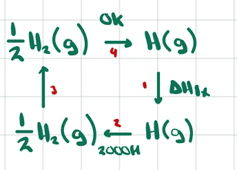

Draw a Hess's Law cycle for (1) involving the formation of the species from the elements. What additional information do you need?
Here is the cycle. We are interested in the enthalpy of reaction 1.
Hess cycle diagram: one half H2(g) at 0K goes to H(g) at 0K by reaction 1 with DH_rx; arrow 2 leads from H(g) to half H2(g) at 2000K, arrow 3 leads up to half H2(g) at 2000K, and arrow 4 from half H2(g) to H(g) at 2000K is labelled DH_f.
$$\Delta H^\circ_{rx}-\Delta H^\circ_f(H,g,2000\text{K})+\Delta H_3+\Delta H_f^\circ(H,g,0\text{K})=0$$
$$\Delta H^\circ_{rx}=\Delta H^\circ_f(H,g,2000\text{K})-\Delta H_f^\circ(H,g,0\text{K})-\Delta H_3$$
$$=12.74\text{kJ}-\int_{2000}^0\frac{1}{2}\text{mol}\cdot 28.82\mathrm{\frac{J}{K\cdot mol}}dT$$
$$=12.74\text{kJ}-(-28.82\text{kJ})$$
$$=41.56\text{kJ}$$
Which seems to be correct.
What I had wrong in my original calculation, ie just the difference in enthalpies of formation is shown in the cycle: we can only simply take this difference when the reactants and products are at the same temperature.
We break the bonds of the reactant (##H(g)## at ##0\text{K}##) and we get ##\frac{1}{2}H_2(g)## at ##0\text{K}## plus a change in energy (##-216.07\text{kJ}##).
The enthalpy of formation of the product (##H(g)## at ##2000\text{K}##) seems to be based on ##\frac{1}{2}H_2(g)## at ##2000\text{K}##. This enthalpy of formation is ##+228.82\text{kJ}##.
Thus, to use the ##\frac{1}{2}H_2(g)## at ##0\text{K}## we have to heat it up which requires ##28.82\text{kJ}##.
Therefore, to get from the reactant to ##\frac{1}{2}H_2(g)## at ##2000\text{K}## we use ##-216.07+28.82=-187.25\text{kJ}##.
We now add in the energy ##+228.82## required to form ##H(g)## at ##2000\text{K}## and the total energy is ##+41.56\text{kJ}##.

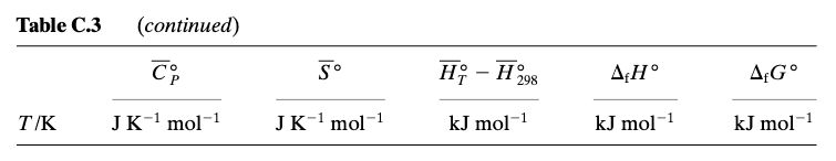

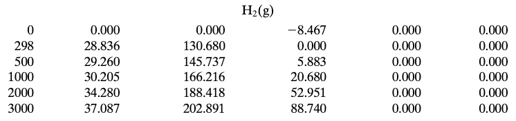

The table entry for ##H_2## is
Header row of a table titled Table C.3 (continued) with columns: molar heat capacity C_P degree in J K-1 mol-1, standard entropy S degree in J K-1 mol-1, H_T degree minus H_298 degree in kJ mol-1, enthalpy of formation Delta_f H degree in kJ mol-1, and Gibbs energy of formation Delta_f G degree in kJ mol-1, with T/K as the row label.
Table of thermodynamic data for H2(g) at temperatures 0, 298, 500, 1000, 2000 and 3000 K, with five numeric columns of values.
Which doesn't seem too useful for computing the sum in (1).
Oh well, if you've got it tabulated, you can get it from the values in column 4 (assuming the correct standard state at 0K). At any rate, this gives the book answer.
Don't we need to consider phase transitions? These are not part of the table though right?
Depends. The standard state of H2 at 0K is solid, so if (despite the heading "H2(g)") they are using this standard state at 0K, the phase transitions will be included in the value of H°(0)-H°(298). If on the other hand they do mean H2(g) at 0K, then they must have in mind the cycle you drew in post 3. Either way, the book values give the book answer.
