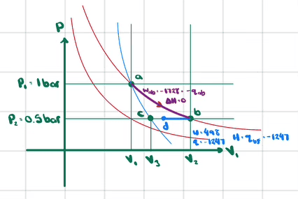

An ideal monoatomic gas at ##1\text{bar}## and ##300\text{K}## is expanded adiabatically against a constant pressure of ##0.5\text{bar}## until the final pressure is ##0.5\text{bar}##.
What are the values of ##q## per mole, ##w## per mole, ##\Delta \overline{U}## and ##\Delta\overline{H}##?

I think the point is that your assumption in bold is incorrect. PVγ = constant applies only to an equilibrium process, i.e. if the external pressure was infinitesimally less than the gas pressure at all points.
I did it a different way, which gets the book answer. Let the gas expand isothermally to point 3 (0.5 bar, 300K). Calculate the work, which equals q as ΔU = 0. To get to the adiabatic endpoint 2, we must lose heat q, while maintaining constant pressure of 0.5 bar. Calculate the change in temperature, hence T2 and V2. Calculate the work, and add the work for the 2 steps.

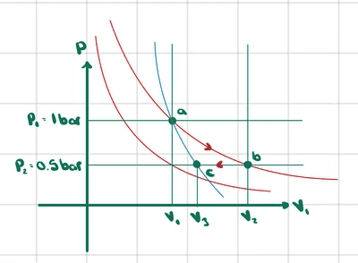

You refer to the "adiabatic endpoint 2". It is not clear what this point is.
In the picture above, there is the point ##c## which is the final point of a reversible adiabatic expansion.
At ##c## we have
$$T_3=T_1\left (\frac{P_2}{P_1}\right )^{\frac{\gamma-1}{\gamma}}$$
$$=227.35\text{K}$$
$$V_3=\frac{nRT_3}{P_2}=0.03780\ \mathrm{m^3}$$
The change in internal energy for the reversible adiabatic expansion is
$$\Delta U_{ac}=w_{ac}=-\int_{V_1}^{V_3}\frac{k}{V^\gamma}dV=-905.92n\ \text{J}$$
So, my question is, after the isothermal expansion, are you moving from ##b## to ##c## or is the final point some other point different from ##c##?
If the final point is ##c## then we have
$$w_{bc}=-P_2(V_3-V_2)=603.94n\ \text{J}$$
$$\Delta U_{bc}=w_{bc}+q_{bc}=\Delta U_{ac}=w_{ac}$$
which we can solve for ##q_{bc}##
$$q_{bc}=-1509.87n\ \text{J}$$
To recap the calculations, to move from ##a## to ##c## the change in internal energy is ##-905.92n\ \text{J}##. If we do this reversibly and adiabatically, this is the same as the work done.
If we go from ##a## to ##b## to ##c## then we do ##-1124.89n\ \text{J}## of work and absorb ##218.97n\ \text{J}## of heat. The end result is also ##-905.92n\ \text{J}## of internal energy change.
However, again, it is not clear to me what the final state is when we do the irreversible expansion. Is it point ##c##?
If it is then final volume is ##V_3## and so
$$w_{irr,ac}=-\int_{V_1}^{V_3} \left ( 0.5\cdot 10^5 \mathrm{\frac{N}{m^2}}\right ) dV\ \mathrm{m^3}=-643.15n\ \text{J}$$
which is smaller than the change in internal energy. Where does the rest of the change in internal energy come from?
I am not sure what to conclude.

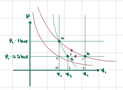

Apologies for not making it clearer. I hadn't fully thought it through myself.
By "adiabatic endpoint 2" I meant what you called "state 2" in your original post; i.e. the end point of the irreversible adiabatic expansion at 0.5 bar.
I should have specified that I intended an irreversible isothermal expansion at constant external pressure of 0.5 bar. The work would be -0.5*(V2-V1) = -1247 J/mol.
At this point let me insert your picture, with some extra points labelled for clarity. The difference here is that by point c (also labelled y) I intend "state 2", the endpoint of the irreversible adiabatic expansion. This will be different from your point c because the adiabat PVγ = constant is only followed in a reversible process.
Going from a to b absorbed heat 1247 J/mol. We now lose this heat isobarically and the temperature changes
ΔT = q/Cp = -1247/20.785 = -60 K; T3 = 240K; V3 = 0.0399 m3/mol
wbc = -0.5*(V3-V2) = 499 J/mol
w = wab + wbc = -748 J/mol
Diagrammatically, w equals the area of the rectangle WXYZ, which is equal to WXRS minus ZYRS.
ΔUac = wac as you said.
ΔHac = ΔHab + ΔHbc
= 0 + CpΔT = -1247 J/mol
In the irreversible adiabatic expansion we have no heat exchange and only work is done
$$w_{irr,af}=-\int_{V_1}^{V_f} P_2dV=-P_2(V_f-V_1)\tag{1}$$
This is the same as the change in internal energy of the system between the initial state and the unknown final state.
We don't know what ##V_f## is at this point.
Note that from the ideal gas law
$$T_f=\frac{P_2V_f}{nR}\tag{2}$$
If we construct a reversible path to this final point then we know that the change in internal energy must be the same as in the irreversible case.
One reversible path is an isothermal expansion to pressure ##P_2## and volume ##V_2## and then an isobaric process from ##V_2## to ##V_f##.
The total change in internal energy is
$$\Delta U_{af}=\Delta U_{ab}+\Delta U_{bf}=\Delta U_{bf}=w_{bf}+q_{bf}\tag{3}$$
$$=-P_2(V_f-V_2)+\frac{5}{2}R(T_f-T_1)\tag{4}$$
where I used
$$q_{bf}=\Delta H_{bf}=\int_{T_1}^{T_f}C_p\cdot n dT=\frac{5}{2}nR(T_f-T_1)$$
We equate ##\Delta U_{af}## to ##w_{irr,af}## and solve for ##V_f##.
We get
$$V_f=0.0399072n\ \mathrm{m^3}\tag{5}$$
So the final state is a point that is between points ##c## and ##b## in the picture.
The total work done equals the change in internal energy and
$$w_{irr,af}=\Delta U_{af}=w_{bf}+q_{bf}=-748.26n\ \text{J}$$
The total change in enthalpy is
$$\Delta H_{af}=\Delta H_{ab}+\Delta H_{bf}$$
$$=0+q_{bf}$$
$$=-1247.1n\ \text{J}$$
Here is a picture illustrating what I have done above.
ΔHac = ΔHab + ΔHbc

$$=\frac{-1247.1n}{\frac{5}{2}Rn}$$
$$=-60\text{K}$$
Thus, ##T_d=240\text{K}##.
At this point we can use the ideal gas state equation to find ##V_f=0.03990\mathrm{m^3}##.
We have all the state variables at each of the equilibrium points of interest.
The work to get from ##b## to ##d## is
$$w_{bd}=-P_2(V_d-V_2)=498.84n\ \text{J}$$
The total work for the two stages of your irreversible process is
$$w_{ad}=w_{ab}+w_{bd}=-1247.1n\ \text{J}+498.84n\ \text{J}=-748.26n\ \text{J}$$
This is the same value as
$$w_{ad}=-P_2(V_d-V_a)=-748.26n\ \text{J}$$
Here is a picture showing your calculations
Chestermiller said:
There is no need to consider a reversible path in this analysis unless you also want to determine the entropy change for. the system. In that case, the reversible path is not adiabatic.
I think your solution is yet a third way to solve the problem. And it is the simplest and most efficient of the three.
As you mention, and as I also noted in my post #8, the reversible path I considered is not adiabatic. But it does reach the same final state, which seems to be what matters.
All you did was compute the irreversible work for the single irreversible adiabatic process and you equated that to the change in the internal energy which for an ideal gas is change in temperature times ##C_V##.
The variable in this equation is the final temperature, so you solve for that first.
Everything else follows from that.
Final volume is obtained from the ideal gas law.
Internal energy change can now be computed with the final temperature.
Change in enthalpy is just ##C_P\Delta T##, which we also know because of the final temperature we discovered.
Note that I added a new picture to show what I did
Maybe this clears it up for you.
I think your method is neater than mine because it doesn't require the assumption of an irreversible isothermal process, only using the state functions of a and b, and the work of ac and bc. Chestermiller's is the most succinct I think.
