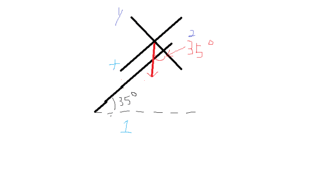

How Do You Calculate Angle 2 in a Physics Vector Problem?
  • Thread starter Thread starter hvidales
    Angle Picture
hvidales
29
So angle 1 was giving and through that they found angle 2. I need help on how they found angle 2. The dark red arrow is a vector. This is a physics problem asking for something else but I got stuck here lol.
Add another line parallel to ground intersect x-y origin.

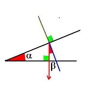

The angles are congruent as their arms are pairwise perpendicular. The red vector is vertical, makes a right angle with the horizontal arm of angle 1. The other arm of angle 2 is perpendicular to the slope which is the other arm of angle 1. See picture: β=90-(90-α)=α.

What happened with the x axis? I updated the picture to look better.
