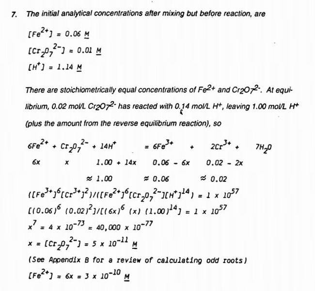

Fe2+and Cr2O72- react as follows: 6Fe2+ + Cr2O7 2− + 14H + >>> 6Fe3+ + 2Cr3+ + 7H2O.
The equilibrium constant for the reaction is 1×10^57. Calculate the equilibrium concentrations
of the iron and chromium species if 10 mL each of 0.02M K2Cr2O7 in 1.14M HCl and 0.12M FeSO4
in 1.14M HCl are reacted.
https://physicsforums-bernhardtmediall.netdna-ssl.com/data/attachments/97/97696-2f7ec586395970f64d734682baf6f166.jpg
This is the solution provided . I still don't understand as Cr3+ is 0.02M in the equation as the question give is K2Cr2O7 is 0.02M > does it mean 0.02M of Cr2O72- ? Same goes to iron .
Elaborate please, I have no idea what you mean.
Chances are you are forgetting about dilution, but that's just a wild guess.
I think there is a mistake in the text; when it says "At equilibrium 0.02 mol/L Cr2O72- has reacted..." that should be 0.01 mol/L Cr2O72-. Is that the problem? I think the expression here is unclear. But then you say "same goes to iron". Are you just forgetting about dilution, as Borek suggests?
