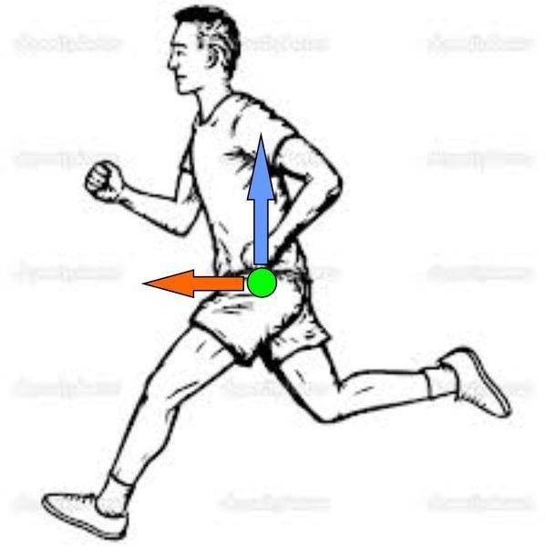

For the second question, from a crude perspective, ignoring all losses, a runner needs no force to keep going at constant speed. The minimum forward force to complete the run is therefore that needed to provide a constant acceleration to cover the given distance in the given time. This will be tiny and wholly unrealistic.
However, the other info given allows you to draw a free body diagram of the runner (except - they don't give you the hip width or leg length, so I'm not sure you have all the necessary data). Based on the posture, gravitational force, and the assumption of constant speed you might be able to work out the compression in the leg.
The problem I foresee with this appoach is that we can evaluate the forces acting at the centre of gravity (green dot) of the runner. Light blue his weight and orange the force providing the acceleration, but due to the complicated lever system connecting this to the ground one cannot easily evaluate the force at the foot. Maybe measure it with accelerometers?

For the running problem I would think that a real person would quickly accelerate up to their max speed (within about 3 strides?) and then one would get a slight drop in speed as the advantage of the lever system decreases as the leg pivots backwards and repeat with the other leg, so it would be a sort of sawtooth function with time. The force from the leg is thus used to accelerate the person from a lower to a higher speed with each stride. This suggest that one should rather use an average speed for the whole of the event.
