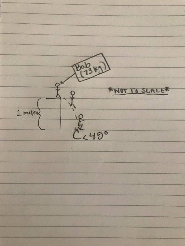

Scenario: Bob (73kg) steps off a 1-meter high platform and properly absorbs the fall with bent legs in a squat position.
Question: How much counterforce required to slow the impact to a stop without Bob's legs going past 45 degrees?
I am trying to figure out how much someone would need to squat in a weight gym setting to be able to safely absorb impact from height. I have little to no experience in physics /: but I could not find anything online that was specific.
I have no equations because that's what I am trying to figure out.
I apologize for my lack of knowledge or helpful information! If there is any other information needed let me know! Thanks, guys and gals!
Referencing drawing:
Handwritten sketch on lined paper of a stick figure labeled Bob (73 kg) standing on top of a vertical block 1 meter tall, with a dashed arrow to a second stick figure below, and the angle C < 45° marked; the note says NOT TO SCALE.
Hello twadd, ##\qquad## :welcome: ##\qquad## !
I have no equations
You need some. What have you learned so far that might apply ?
And: make an educated guess about the given "without Bob's legs going past 45 degrees"
(Hint: In the sense of 'how long is the stopping trajectory')
twadd said:
Relevant Equations: I have no equations because that's what I am trying to figure out.
"Relevant Equations" here means standard equations that you have been taught and may be relevant to the problem.
You have a mass falling through a height, force, and the distance Bob through which the force applies as Bob bends his legs. What physical quantity relates these?
