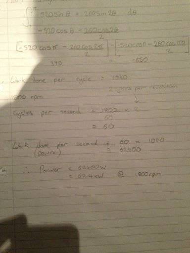

Hello, this is my first post on the forum and I am just looking for some help solving a problem.
T = 520Sin(Ө) + 260Sin(2Ө)
The engine has two working strokes per revolution
Graph produced from equation
Working out for power produced at 1800rpm
Now i need to work out the the greatest fluctuation in energy per revolution.
Can anyone point me in the right direction on where to start?
I can provide more info if needed.
All help greatly appreciated.

Hello forbes-1234. Welcome to PF !
Please give the complete problem as it was given to you, word for word.
It has been established that the variation in output torque T (Nm) of an engine in relation to the crank angle is given by -
If the are two working strokes per revolution you are asked to calculate -
a) The power developed by the engine at 1800 rpm
b) The greatest fluctuation in energy per revolution
I have completed part a) and believe my answer is correct, I integrated the equation then put the limits (in radians 0 and Pi) into the equation and subtracted the answer from the lower limit from the answer from the upper limit.
Fairly simple integration question.
However this next question is more of a mechanical principles question and need a place to start from.

What is the formula for power in terms of T and other quantities?
I'm not quite sure what you mean. All the information provided above is what I have. Only the equation for torque is given in relationship to crank angle in the question.
The area under the graph is the work done per cycle.
The amount of cycles per second is the speed divided by 60, then multiplied by 2 because there is 2 cycles per revolution.

I mean: type out the formula here; I cannot really make out the attached handwritten stuff on my computer screen.
Ok the handwritten stuff is the working out for the power produced at 1800 rpm, first off is the integrated version of the equation for torque in relationship to crank angle.
I have then used the limits to work out the area under the graph which is equal to the work done per cycle.
This works out to be 1040 Joules.
At 1800 rpm the number of cycles per second = (1800/60) x 2
Cycles per second = 60
Therefore power developed at 1800 rpm = 60 x 1040
= 64200 W
= 64.2 kW
Does this add up to you?

I did it slightly differently to you, although I got the same answer I didn't quite understand your method.
If integrating from 0 to 180 degrees (half a revolution) produced 1040 J/s, then one complete revolution (360 degrees) produces 2080 J/s which is 2080/60 = 34.6667 J/m
Multiplying by 1800 = 62,400 = 62.4kW @ 1800rpm.
