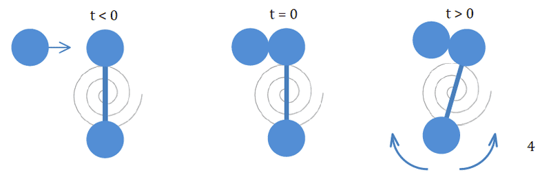

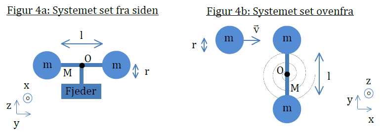

I need to find the maximum contortion of a torsion spring, for a given system. Most of the assignment I have done correct, but this last part I simply cannot get right. The pictures below is what I have used, but they are probably not necessary for this problem.
Two-panel physics diagram: Figur 4a shows the system from the side, with masses m on a horizontal rod of length l pivoting about O, a labelled rod M, a spring labelled Fjeder below, and radius r; Figur 4b shows the system from above, with a moving mass m with velocity v hitting one end of the rod, which has masses m at both ends and pivots about O.
Three-panel diagram of a rod with a ball at each end on a spinning pivot, with a ball approaching from the left. Panels labeled t < 0, t = 0 and t > 0 show the balls colliding and the rod then rotating, with curved arrows indicating the direction of motion, and the number 4 at the right.

  • Two-panel physics diagram: Figur 4a shows the system from the side, with masses m on a horizontal rod of length l pivoting about O, a labelled rod M, a spring labelled Fjeder below, and radius r; Figur 4b shows the system from above, with a moving mass m with velocity v hitting one end of the rod, which has masses m at both ends and pivots about O.
  • Three-panel diagram of a rod with a ball at each end on a spinning pivot, with a ball approaching from the left. Panels labeled t < 0, t = 0 and t > 0 show the balls colliding and the rod then rotating, with curved arrows indicating the direction of motion, and the number 4 at the right.

To find ##\omega_0## you need to conserve angular momentum before and after the collision. Linear momentum is not conserved because the two masses forming the dumbbell are presumably constrained from moving. Mechanical energy is not conserved because the collision is inelastic.
Right after the collision, mechanical energy is conserved. Initially all the mechanical energy is kinetic while at maximum angular displacement all the mechanical energy is potential. So you set the two equal to find the maximum angular displacement.
