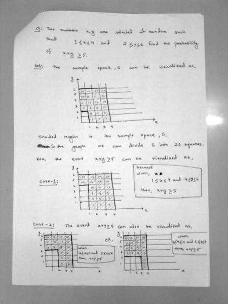

Let’s select two numbers x and y such that 1<=x<=4 and 2<=y<=6. What is the probability of x +y>=5?
I solved the problem and attached it. Please check my solution and tell me whether my approach of solution is correct or wrong. The most puzzling matter is that I'm getting two different answers. Any suggestion would be of great help to me regarding my attempted solution. Thanks.
  • Handwritten probability solution on lined paper with three grid diagrams of x against y, shaded regions for x + y >= 5, with case-1 and case-2 boxed notes.
  • Handwritten solution comparing two probability calculations for x + y >= 5: case-1 gives P1 = 20/22 = 10/11 = 0.909, case-2 gives P2 = 18/22 = 9/11 = 0.818, with the question Which answer is right? P1 or P2?
If I'm reading what you are doing correctly, it looks like the sample space you drew is an "or" rather than an "and". That is your first picture looks like 1<x<4 "or" 2<y<6. If you do an "and" instead then you should get a box, not a tetris piece.
