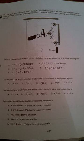

For the second picture, I do not know how to solve the last question on resultant force of the traction device that exerts on the foot. Please refer to picture:
For my attempt, I came up with my x and y scalar components and tried adding them but nothing came out to be any of the values. I am just very confused with this problem.

For 25, I assume you've solved the other three parts (and so have your x- and y- components). Now, as with any vector whose components are known, use the Pythagorean theorem to get the magnitude of the resultant traction. To get its angle, take the inverse tangent of the y component over the x component.
